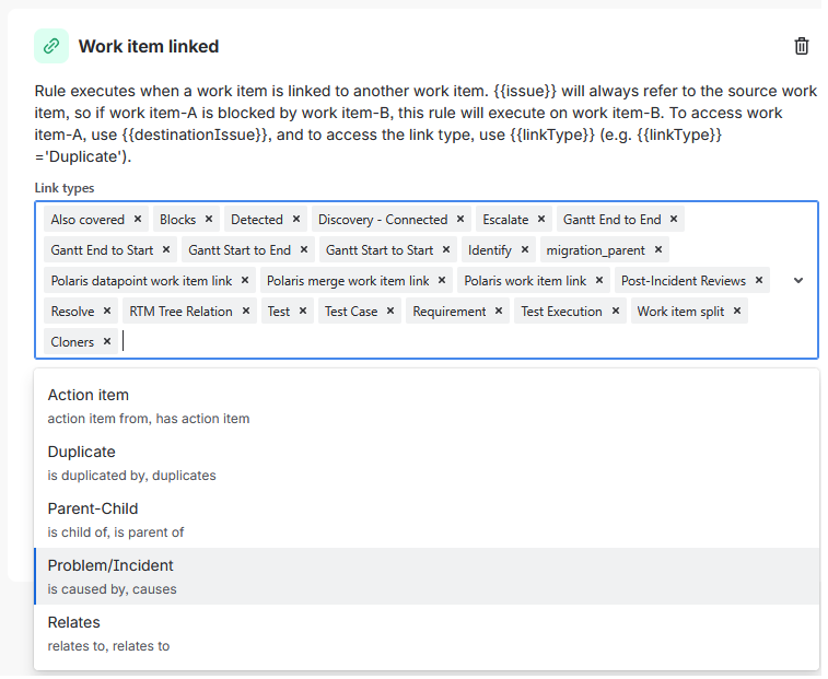

I tried to create a automation which is triggered when a new link is created. As for the user, the list of possibilities is endless. So I tried to grab ALL of the types which should not be used: (why not c&p from clipboard in this editor here? -> inconsistency)
Now comes the first quirk: It's seems NOT possible to refer to the just created link itself, the one which triggered the rule - which is the one I want to simply delete. Am I wrong?

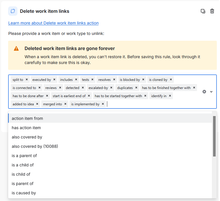

It seems only possible to delete ALL links of a specific type - In my case that could be accepted, but what would you do if you want to just delete this specific created one?
Ok, so let's delete all of a specific type. But there comes the next quirk: The selection list looks very different.
And, only for now, comes the last quirk: While in the trigger you can select "Requirement" there is no such possibility to select "is required" or "required by" or similar. What am I missing?

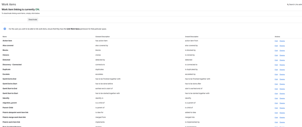

Staffan Redelius
March 17, 2026
Hi @Jochen Betz
If you go to Jira settings (cogwheel )-> Work Items -> Work item linking you can remove the Link type you don't want the users to use and replace it with the correct one. That way you will clean up and reduce the number of options.
Just remember this is a global setting so it will affect all spaces and issue types.
It seems a bit backwards to create an automation to fix this afterwards instead of reducing the number of available link types but in theory you probably could be create a IF/Else statement going through all the link types and replace them with the one you want.

Jochen Betz
March 17, 2026
Thank you @Staffan Redelius , that is indeed a place I did not discover yet. Unfortunately I can not use that, because as you said: It's global And it should only apply to specific work item types or projects.
I also agree with you that trying to fix it with automation is quite a bit backward "solution" but the only way I found so far. I would love to have a clean way at the "head of the horse", but as so often Jira as is does not provide such a thing. Thus the huge amount of 3rd party apps/addons to fix all this issues.
Using if/else is not a solution neither, because I don't know the intention of the user.
So yes, your answer helps a little for understanding but unfortunately not to solve the problem. On the pro side: it shows a point which is not clear from the automation side: "when" refers to the "Name" of the link "type" while the "in/outward description" are used in the "then part"
