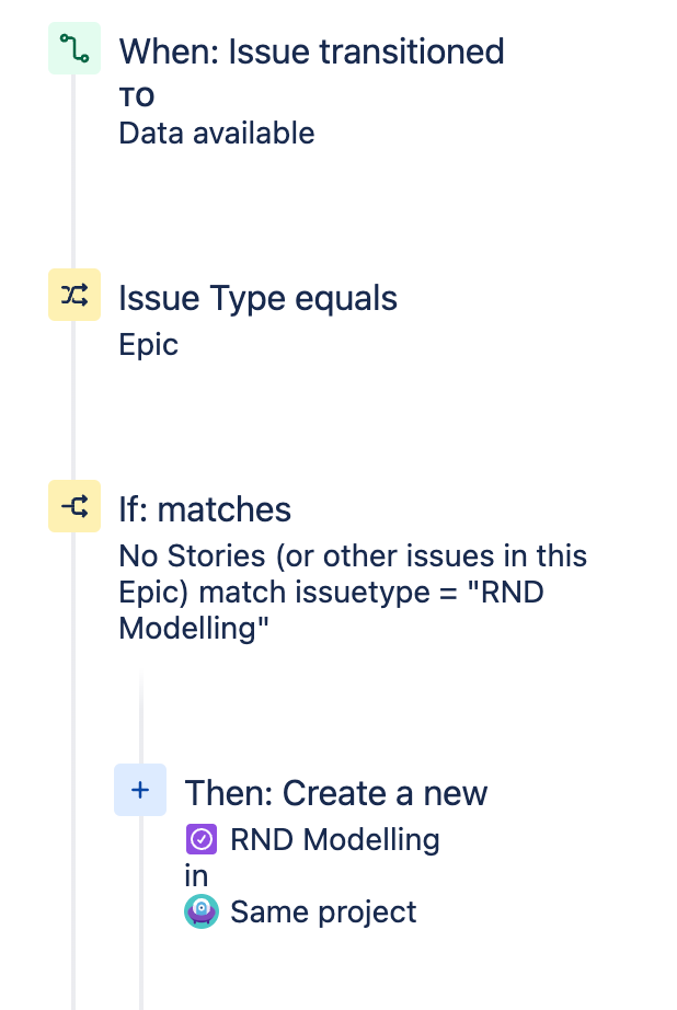

Javanshir Mustafayev _ HIT
November 27, 2022
I've managed to build the logic on my side and after tests, it is workingScreenshot 2022-11-28 at 09.49.18.png

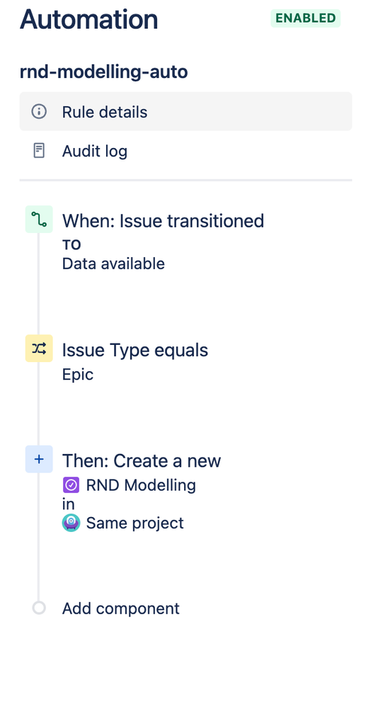

November 18, 2022
@Cascapera Davide
I have no conditions now:
When the epic is transitioned to STATUS, then create an issue.
I would like to add a check if the same issue type is already present under this particular epic, then skip the creation of the issue of a particular type.
I'll add a screenshot of how my rule looks now below:

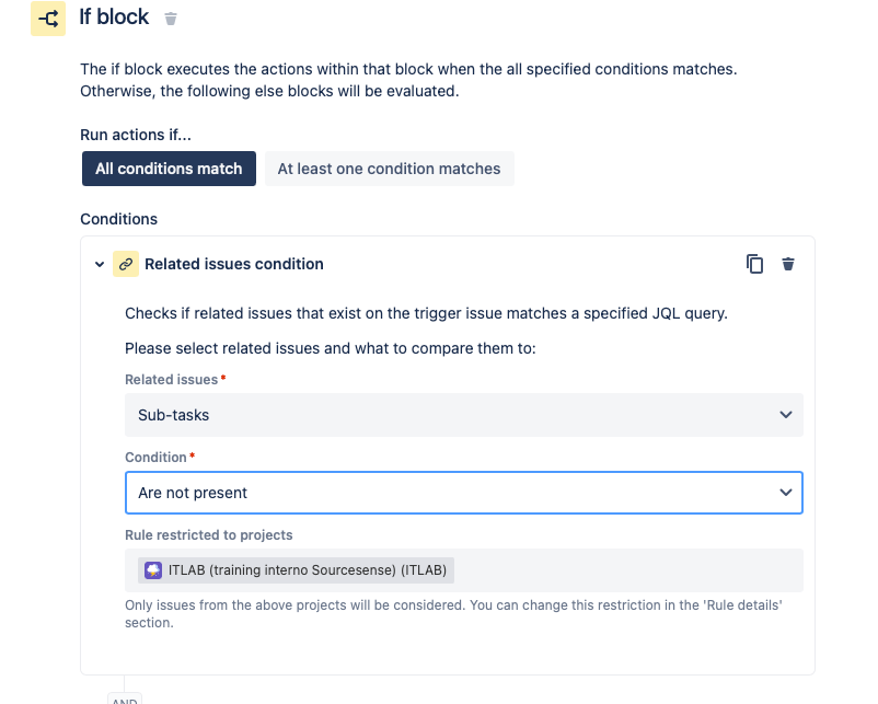

Cascapera Davide
November 18, 2022
add this if else condition u can  change the type (I used sub-task in this screenSchermata 2022-11-18 alle 12.12.25.png)

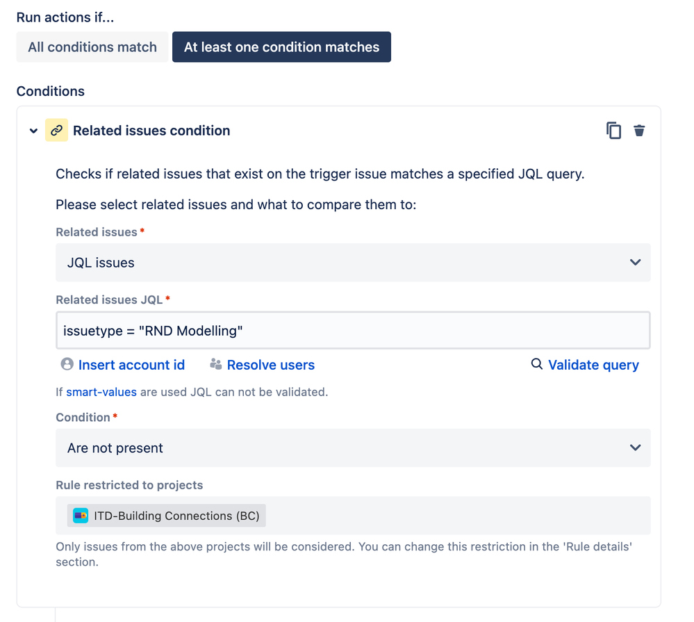

November 18, 2022
@Cascapera Davide
tried this using the config on the screenshot and the automation stopped creating the issue no matter if there is one or notScreenshot 2022-11-18 at 20.23.50.png
November 18, 2022
@Cascapera Davide no, this doesn't matter at all. try it yourself in any filter or advanced search it's not case sensitive for issuetype or issueType
Cascapera Davide
November 18, 2022
I try it in my test project and it works
November 18, 2022
@Cascapera Davide please try with a JQL where you specify the issue type like it is needed in my case. Your example works with subtasks, this doesn't work for my case.
