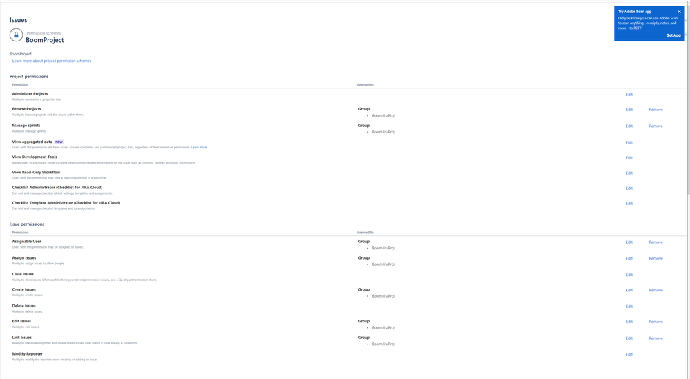

Hi Vikrat I tried your advice but am no closer to solving it
I created a permission scheme, but don't know how to make it project specific
One would think that it should be straight forward to create a project and allow only specific user access to it
or create a permission scheme that only allows access to a single project
Cheers Warde
(It does not help that the help articles don't reflect exactly the options i see :-)

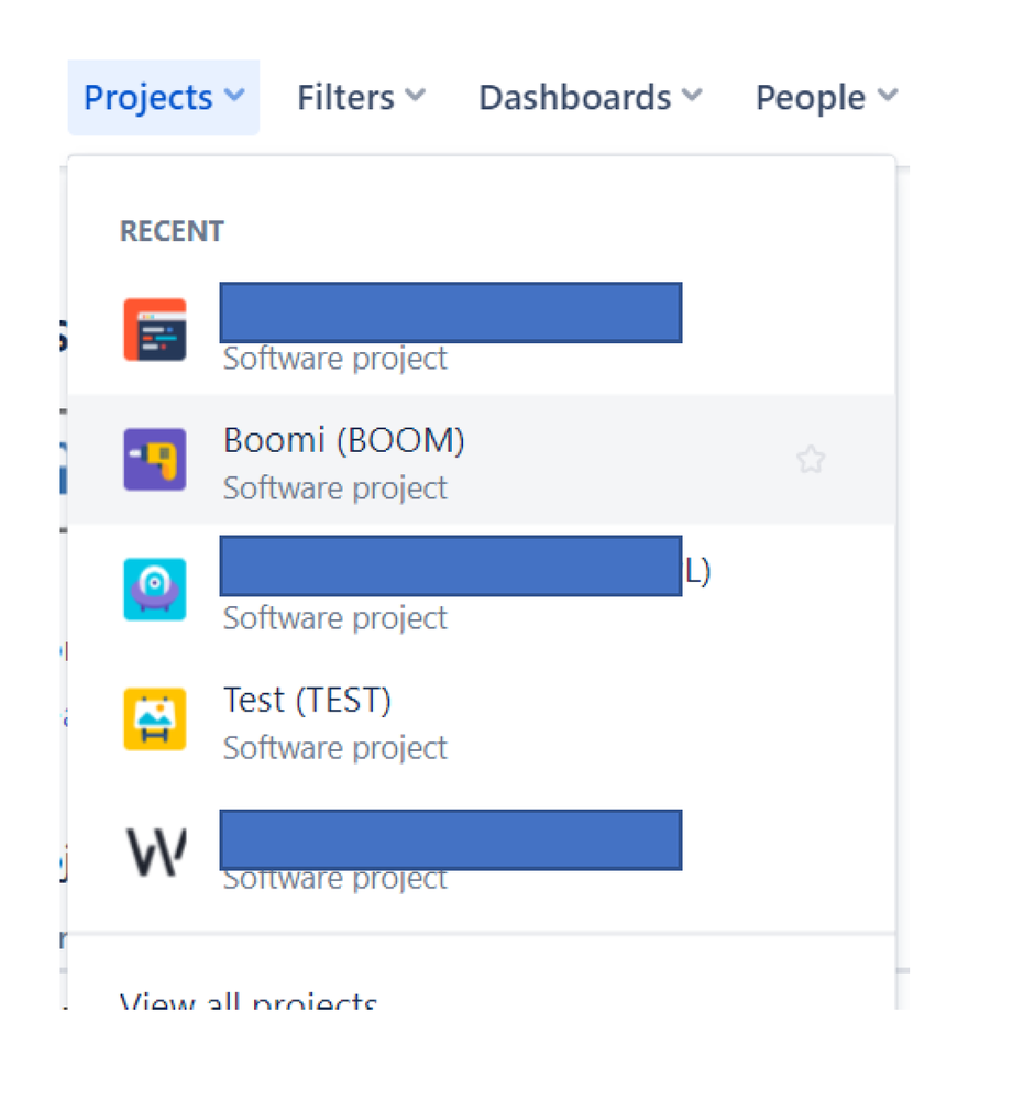

I have added some screem image below....I set up  BoomProject permission scheme which I assume applies to the project 'Boomi (Boom)'
and I want to assign the user just this permission
Screenshot 2021-08-05 205313.pngScreenshot 2021-08-05 205341.pngScreenshot 2021-08-05 205517.png

Hi @Warde Wynter  If Projects are using Default Permission Scheme,in those project  Any Logged in User, can browse issue and create issue.
In Order to Restrict project A and B from ( user 3) , create a seperate permission scheme for A and B projects only and add Remove  "Application access (Any logged in user)" from permission scheme. So that users ( 1 and 2) which are added to Project A and B project role can see both project A and B but hidden for User 3.
In Project C, keep default permission, so that any user 1,2,3,4...can access and create issue.
Kindly check permission for Project A and B,,, if Application access (Any logged in user) is added under Create Issue and Browse project, it means User 1,2,3 can project A and B.
If project is already having seperate permission schemes, then you only need to add user in project role.
Vikrant Yadav
August 5, 2021
Thanks @Warde Wynter  For the screenshot, If this Permission scheme is mapped with Bhoomi project, then users which are added in Bhoomjiraproj group can only access this project. Other user can't see this project.
