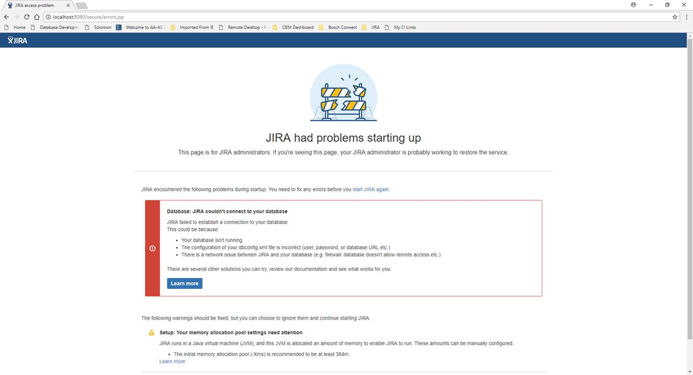

Our team currently uses JIRA cloud instance and is planning on setting up on prem server in near future. I am performing POC to migrate data of certain projects from the backup file of cloud instance. Based on some readings I did, all the plugins currently running on cloud instance must be present on server as well. However, few plugins present are specific to cloud instance hence I failed to import.

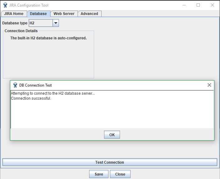

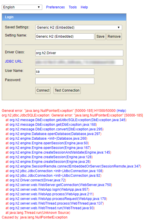

A colleague recommended to use "Restore System" instead of Import Project. This time I have not installed plug ins on new server. After restoring I lost connection with database. JIRA Configuration Tool says connection successful but h2 console displays otherwise.
Any help in migrating data is much appreciated!

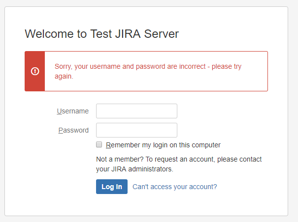

I have switched database to MSSQL 2012 (just a comfortable choice) and noticed an interesting thing. Data got imported to few tables and not all (when alphabetically sorted data exists up to jiraissue table, rest of the tables are empty).
I have tried to login with my credentials and another admin credentials but it continues to pop up below message. Wonder if JIRA is unable to identify login as data pertaining to user management has not been imported.
Any thoughts on how to identify root cause?
Nic Brough -Adaptavist-
June 7, 2018
When you move from Cloud to Server, the user IDs become disconnected from the Cloud user directory.
The export/import process is aware of this, and creates a system admin account for you to use to get into your server install and reconfigure it all.  Log in as sysadmin with a password of sysadmin too.

Sravya Vuggina
June 13, 2018
Hello @Nic Brough -Adaptavist-,
I did try with sysadmin/sysadmin credentials too. Unfortunately, it gives the same error or incorrect username and password.

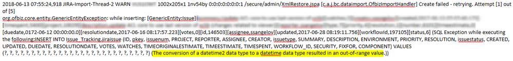

This time I increased JVM memory, created MSSQL database with collation and isolation as recommended in JIRA installation guidelines. Yet the import process failed at 69% (same as before) as here is what log file states. - The conversion of a datatime2 datatype to a datetime data type resulted in an out-of-range value.
The schema of jiraissue table doesn't contain any fields with datatime2 database (atleast in 7.9.2). Wonder if that was how it was in prior versions. Is this a know issue?

Andy Heinzer
June 14, 2018
Hi Sravya,
I have not been able to find any documented bug ticket or KB articles in Atlassian that reference that specific error message.  In our customer support portal, I did find a very small number of users that reported this problem with that error message.
In these, it appears that your data for some reason has that duedate value with a year of 0172.  In a datetime2 data type, that's fine.  However the datetime values have to be between 1753 and 9999.   But I have not been able to clarify why this might have been happening.  It's possible it was a still undocumented bug, but it might be something more environmentally specific here.
I don't know what value 0172 is supposed to represent for the year of a due date.  Is your data possibly using a non-Gregorian calendar?
In the other cases I found of this, it required the end user to open the backup.zip file and then manually edit the entities.xml file to replace these values in the backup file with valid datetime values.  Only then could you then save that file, add it back to the zip file and use that to complete the import.

As recommended, I tried unzipping the file to alter entities.xml file. However, since the file is too big it isn't opening. Instead I have fixed the due date for this specific jira issue and taken backup again. While importing the latest backup file, I again ran into same issue. Not sure if the modifications made in JIRA got reflected to the database (was hoping it would).
Sravya Vuggina
June 15, 2018
Finally I was able to restore!
Used 010Editor to open entities.xml file. Fixed duedate, and imported the data. It worked.. Thanks @Andy Heinzer
