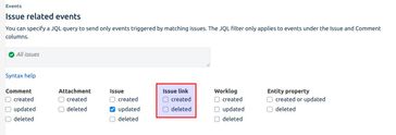

  2. When an issue is linked, the event fired is actually issuelink_created. This can also be seen in the Jira Webhooks configuration page:
Please get in touch with the app vendor by using the resources listed in the support tab of the marketplace page for BigPicture:

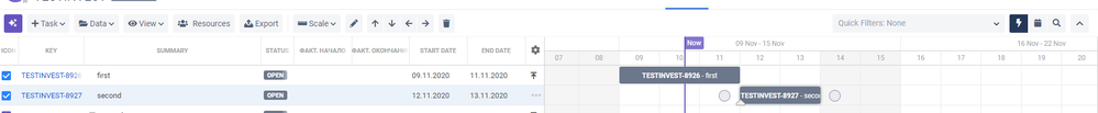

Hello.
As you can see, when I create issuelink thru REST API , it doesn't create on BigPicture:
but it creates in issue links:
Only, when I change description to another value - raise event "issue updated", and after that link creates on big picture:
There is a VBA code:

Please be informed that our developers managed to create a link in Jira using the POST HTTP method. The link appeared in the Gantt chart instantly after refreshing the page. This is the code that was used:
POST https://INSTANCE-NAME.atlassian.net/rest/api/2/issueLinkContent-Type: application/json
Authorization: Basic bWFyY2luLmtpdGFAc29mdHdhcmVwbGFudC5j********
 "outwardIssue": {
 "key": "SCRUM-1"
 "inwardIssue": {
 "key": "SCRUM-2"
 "type": {
 "name": "Gantt End to Start"
Also, our developer found that your code does not meet some of the requirements listed in the documentation. The key differences are:
  • a different HTTP method;
  • a different Endpoint;
  • an additional header 'x-experience-api-version", "1.0.0"'
Please verify if such a command will work for you.
