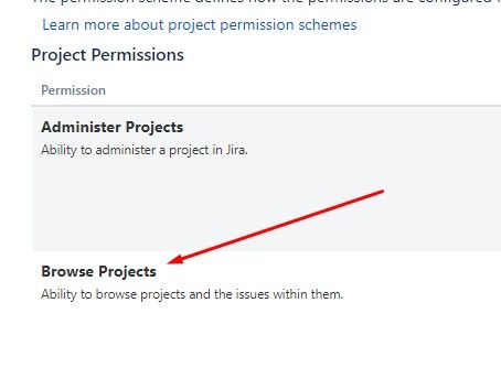

As @Hana Kučerová said, what code is returned? Is it an error code or success code?
Try a simple issue call like /rest/api/3/search or even /rest/api/3/search?jql=key=ABC-123 to just return one issue (where ABC-123 is an issue that you know you can see in Jira) - does this work?
The permission that you need to check, for each project, is

Hello @ericreiner ,
are you able to see issues in these projects?
Please, try to check "Browse Projects" permission.
https://confluence.atlassian.com/adminjiracloud/managing-project-permissions-776636362.html
Even thought you are Site Admin, it is possible, that you don't have access to the projects.
ericreiner
November 15, 2019
I am able to see issues, make changes, etc.  I explicitly added Browse Projects to myself but I am still not getting any responses.
