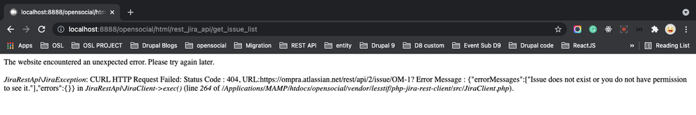

Omprakash Mankar
July 3, 2021
hi, I am also facing the same issue I don't why I have applied to give an above-all solution but working could you please let me know.
you guys have a solution.

Balamurugan Petchimuthu
November 28, 2023
I got the same error but I am using the "Service class with ArrayConfiguration" method, Like the above case If search the URL I can access it, but with my application I can only the error
