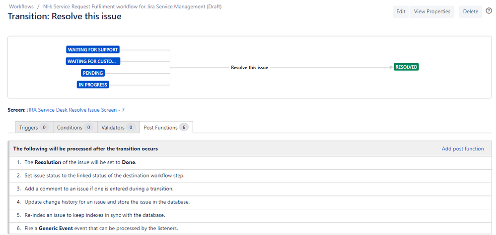

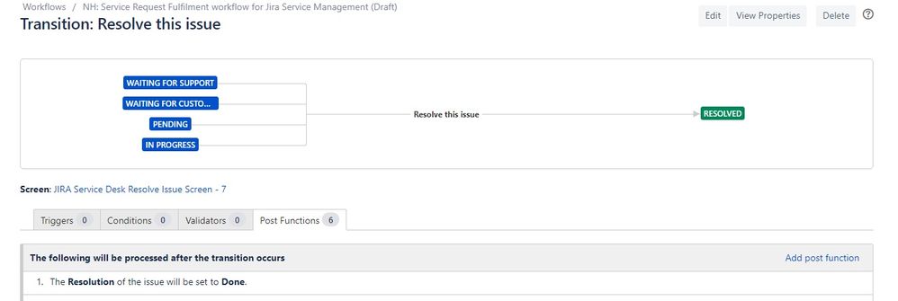

Novakopa
April 8, 2021
I did check post functions and all seem OK, plus I did add an extra one which sets resolved to done. However it did not change anything.Untitled.jpg

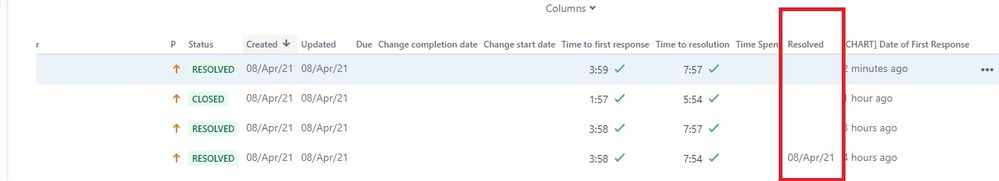

Hana Kučerová
April 8, 2021
Would you please also add the column Resolution to the view?
In general it should work like this:
When you transition issue and during the transition you set the Resolution field (for example to Done), Resolved field (date) is also set (and vice versa - if the Resolution field is cleared during the transition, Resolved field is also cleared)
So, what I'm now trying to find out is if the Resolution field is set for the issues, where Resolved field is empty.
Novakopa
April 8, 2021
Yes you are right, the resolution of these issues is set to unresolved. What would be the way to set resolutions to done whenever the status is changed to resolved. I did add a post function for it, but it seem does not work, or is not for this case.1.jpg2.jpg

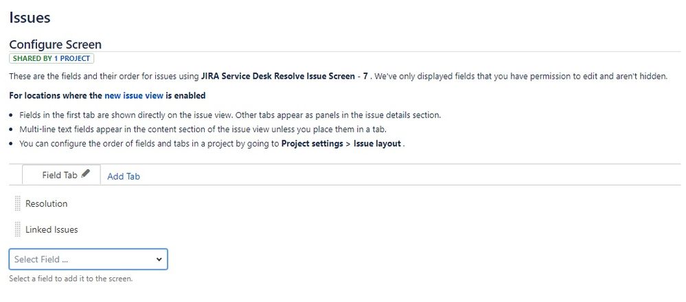

Novakopa
April 8, 2021
Hana Kučerová
April 8, 2021
I would recommend you to try to remove the resolution field from the screen. If you are setting the resolution using post function (everytime you transition the issue to status Resolved), it should be ok.

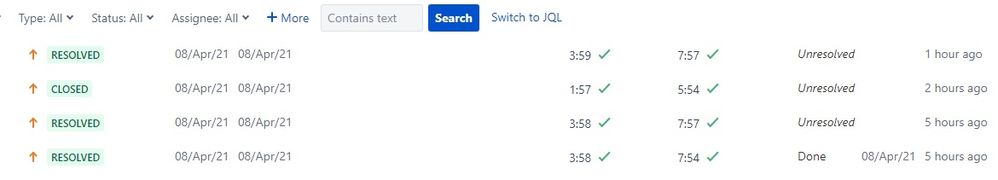

Novakopa
April 8, 2021

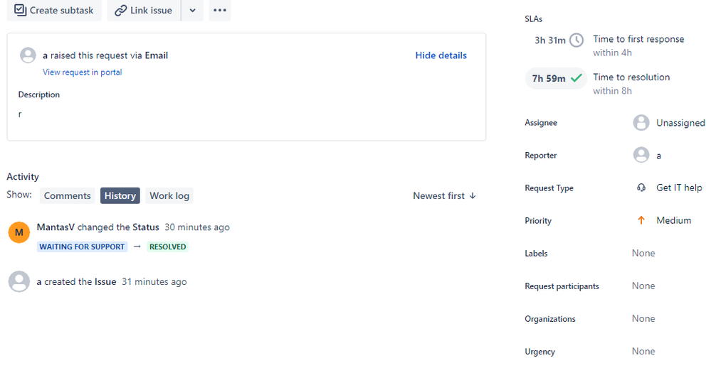

Yes I did set the post function to the correct workflow and transition. Since I deleted the Resolution field from screen 7, now all issues that are set resolved they resolutions status is unresolved, because on the screen there is no more option to set resolution status. However, It is very strange that the use of post function do not help. And the history does not show any interesting information.Untitled.pngUntitled1.png

Maybe just one another check - did you publish the workflow after all the changes?
Novakopa
April 11, 2021
Thank you it did help, I forgot to publish the workflow after editing it.
