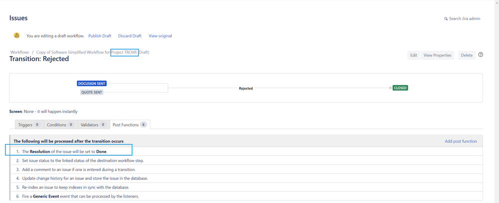

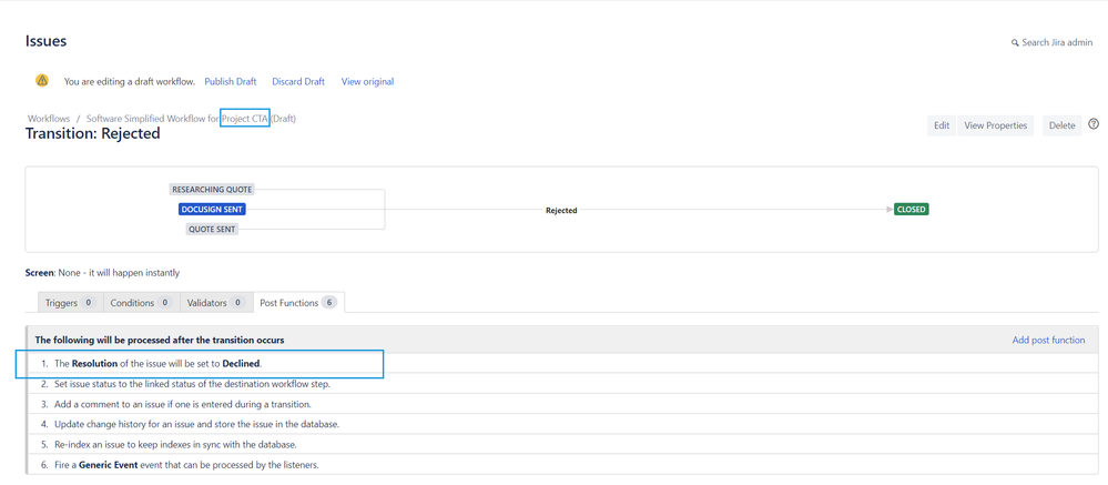

  1. I setup a new workflow for a different project (TROVR) and everything works great. (See Pic A)
  2. Setting up a separate workflow for a new project (CTA) and the resolution refuses to set
  3. I've transitioned 3 test issues roughly 8-10 times after trying different "solutions" found in the community, to no avail.

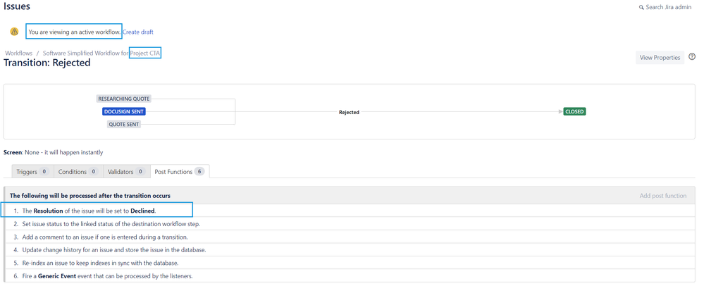

  4. I have setup the first post function as "The Resolution of the issue will be set to Declined". (See Pic B)
    • I moved it to be the second post function. Didn't work.
    • I moved it to be the last post function. Didn't work.
    • I used the default resolution of Done. Didn't work.
    • I deleted the "Rejected" transition and re-created it. Didn't work.
    • I used the workflow for TROVR (see #1). Didn't work.

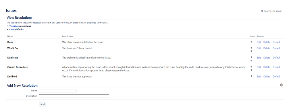

  5. I verified the Resolution of Declined is correctly setup. (See Pic C)

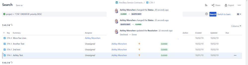

  6. You can see that for my 3 test issues, the resolution isn't set at all. (See Pic D)
  7. These test issues have been transitioned using the "Rejected" transition (seen in Pic A) many times, but the resolution won't set!

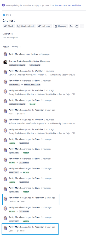

What I did find is that the history of the issues shows I've set the resolution (when it transitions) but as soon as I re-run the search, the resolution is still showing empty. (See Pic E)

Thanks! I wish it was that easy, but I tried that. It was just quicker for me to navigate to the transition through edit. Here's showing it as published:
EDIT: Just to be 100% certain, I tried it again. Here's the history log and the search I ran after that, showing the resolution still doesn't show as set -- even though the history log says I updated it.

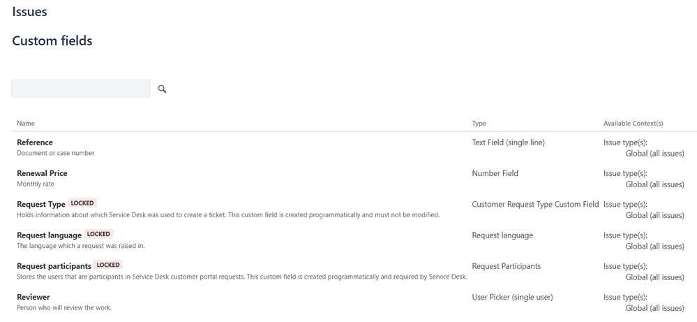

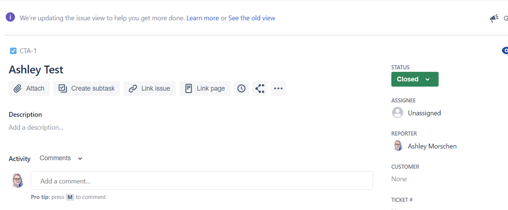

another thought - do you have a custom field called Resolution and mistakenly either setting that or setting the real one but viewing the other in filter result? Long shot but I have sure seen it happen.
Jack Brickey
October 2, 2019
could you check the detailed issue view just to confirm that it isn't being set. something like this.... (new issue view)
Ashley Morschen
October 2, 2019
Unfortunately for me, it's neither of those.
Custom Fields (letter Rs)
custom fields.pngDetailed Issue View
