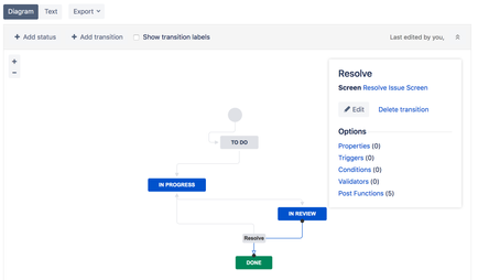

- Navigate to your project > Project settings > Workflows > Click to edit your project workflow(s)
- On diagram mode, click in the transition that leads to the "Done" status (The last status of your workflow)
Choose one of the options below:
1 - In the right menu, click on Edit > Configure the resolve issue screen in the transition view, so the user will be asked to set a resolution when transitioning the issue to "Done"
2 - In the right menu, Click post functions > configure the post function Update issue field to set a value for the resolution field

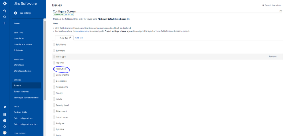

Hi Petterson Goncalves. I am following the exact steps in your option 1 but the resolution screen does not appear when i transition an issue. Is is only the comments box that appear.  I mapped the screen with the transition and the screen has resolution setup. Any clue why that would be? i have tried all sorts. Many thanks
Petter Gonçalves
May 16, 2019
Hello Lulian,
Please, check the possibilities below:
- Have you properly published your draft workflow once you configured the screen?
- Check if the resolution field is not Hidden in project settings > Fields
- When you click to transition the issue, click in the configure fields button to check if the resolution field is not present. Additionally, use the where is my field? option to search for it.
Iulian Toader
May 17, 2019
Many thanks for your speedy reply. So it appears that the resolution field it wasnt included in the Default Field Configuration hence why it wasnt showing.

The correct post function to use in order to automatically set the resolution when transitioning the issue to "done" is the Update issue field. You can follow the steps below to properly configure it:
- On diagram mode, click on the transition that leads to the "Done" status (The last status of your workflow)
- In the right menu, click post functions > configure the post function Update issue field to set a value for the resolution field
- Publish your workflow draft

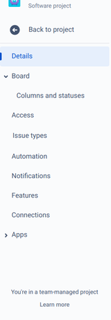

Hello, I am coming back on this topic. I am trying to get my projects workflow in order and was trying to setup the resolution field. I have multiple things that are not in sync with the explanations here.
Firstly, when I try to "update an issue field" using the "Add rule to Done transition" I don't have the resolution field visible.
Then as mentioned, I wanted to see if the Resolution field was hidden, but in order to do this I need to go to Fields section in the projects settings, I don't have this either.
What am I missing? I am the project lead so I should have all the rights to setup my project, no?
