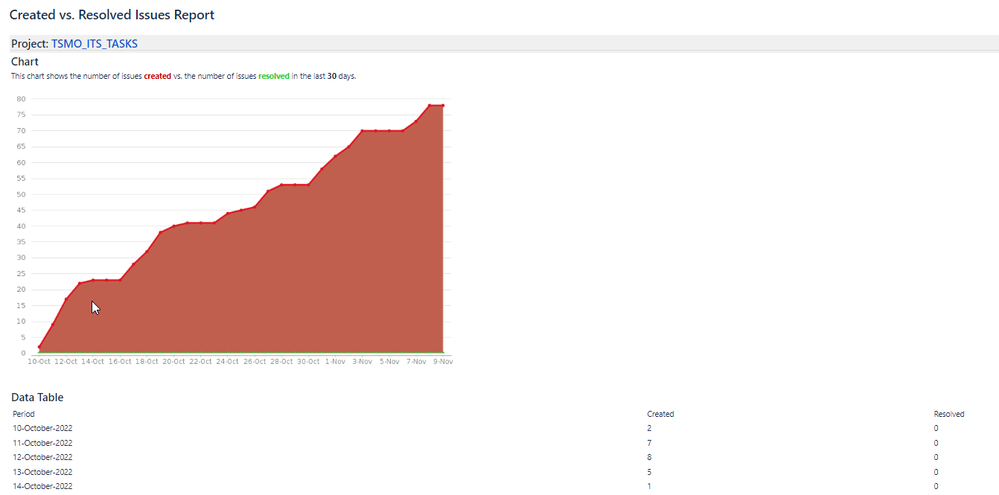

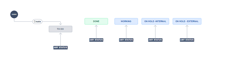

I've been facing this same issue and I can't seem to find a solution. I have a simple workflow for tracking team tasks. This is a team-managed project and not a company-managed so I know I have different options for workflows, transitions, etc. jira-workflow.pngWhen I try to run a created vs. resolved report it only shows created:
The reason for this, I believe, is because there is no resolution set when the status is moved to done:

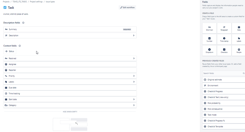

As others have stated "resolution" isn't an available field for the "task" or "sub-task" issue types under this project.
I tried Adrian's suggestion and created a field named "resolved". Using a rule on the transition to "done" I set a value in this field but this had no impact on the reporting.

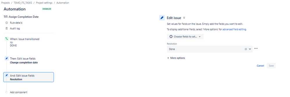

Well, there are times that I can be an idiot and walking away and coming back provides a solution. This is one of those times. All I needed to do was add an "edit issue" rule in automation to set the resolution field to done as below. Would be helpful if it showed up similar to company-managed projects, but at least this will work. Now just have to go edit all the old tickets.
