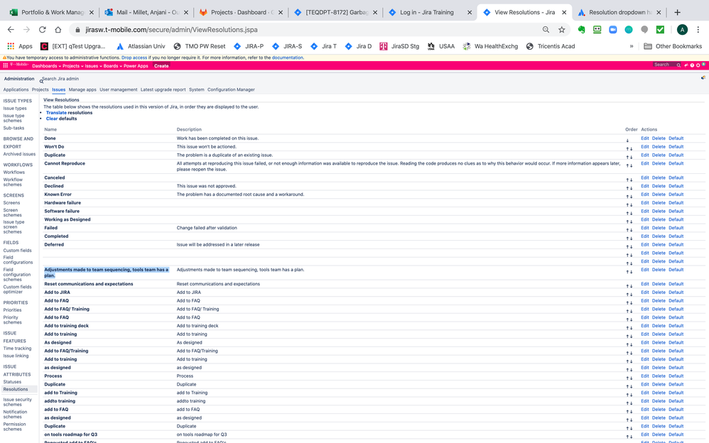

1) Here is a screenshot for View Resolutions; half way down the page, the items in the resolution column begin with
Resolution: "Adjustments made to team sequencing, tools team has a plan.​"

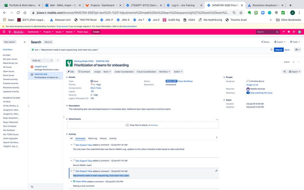

2) This resolution, if put into a jql query, "Adjustments made to team sequencing, tools team has a plan", is pulled from Comments in an issue made by "Ops Support Vijay" in the Working Model STAR project - Vijay is a member of our team.
Every one of these comment-resolutions tracks back to a comment made byt Ops-Support-Vijay on the Working Model STAR project, which is new.
