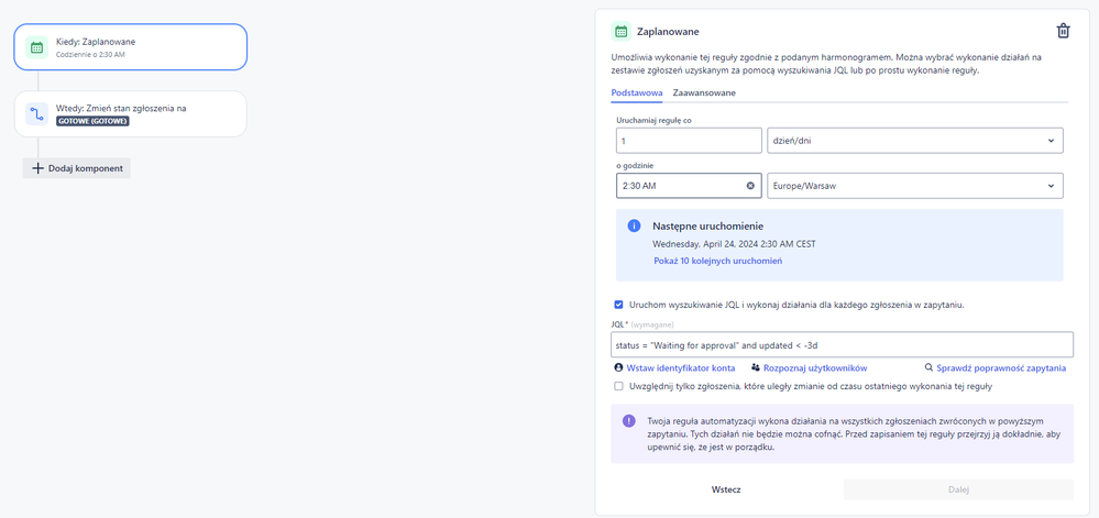

Adrian Goliasz
April 23, 2024
Walter Buggenhout
April 23, 2024
um, yes ... 😅 - I'm afraid my Polish is a bit rusty, so is there a question with those screenshots or the good news that the rule did what it's supposed to do?

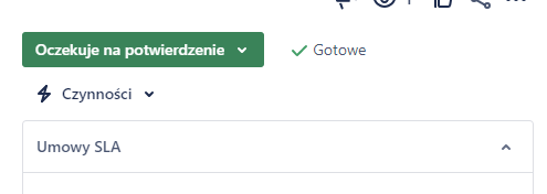

Adrian Goliasz
April 23, 2024
No, the rule did not find the fit tasks.
The second screen presents the task which i want to close by the rule. Oczekuje na potwierdzenie = waiting for approval.
Walter Buggenhout
April 23, 2024
Okay - 2 things: your status does not seem to be Waiting for Approval, but "Oczekuje na potwierdzenie"
If you click on the blue link that says "sprawdź poprawność zapytania" make sure that it does return issues. If you are not sure, copy the JQL statement, navigate to Filters > View all issues and paste the query there. Modify it if necessary until it returns the issue(s) you want to change.
If you are sure that the query is correct, also consider checking the box that is sitting just below the query. In English it means something like "only update issues that were updated since the last time this rule was run". I don't think this is the problem here, but when you are trying a lot of things, this may impact your results as well.
