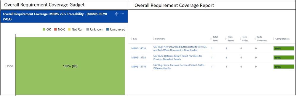

Location: Overall Requirement Coverage Gadget and Overall Requirement Coverage Report with Scope = Test Plan
Assumption:
  1. Xray first finds the Tests linked to the Requirement and then retrieves the latest Test Execution of each Test associated with the specified Test Plan in the specified Test Environments.
Questions:
  1. Which Tests linked to each Requirement does the Xray include in its calculation of the Requirement Test Status - all linked Tests or only those Tests linked to the Requirement via a “Tested by” link?
  2. Does Xray only look at the Test Plan specified in the Test Execution or does Xray also check that the Test itself is associated with the specified Test Plan? (I.e., how does the Xray treat a case in which a Test itself is not associated with the specified Test Plan but one or more of the Test’s Test Executions are associated with the specified Test Plan?)

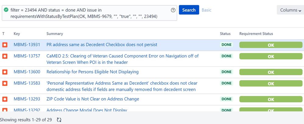

Location: Overall Requirement Coverage Gadget Filter (i.e., the list of Requirements displayed when an area on the Overall Requirements Coverage Gadget representing the Requirements that have the specified Requirement Test Status is clicked).
Note: Jira/ Xray shows that the Filter used to pull the listed Requirements is
filter = < Requirements-specifying Filter> AND issue in requirementsWithStatusByTestPlan(<Requirements Status clicked on the Gadget>, "<Test Plan ID>", "", "true","","","<Requirements-specifying Filter>")
Example: filter = 12345 AND issue in requirementsWithStatusByTestPlan(OK, "PROJ-1111", "", "true","","","12345")
Notice that, though the Overall Requirements Gadget (shown in Requirement Test Status 2) indicates that there are ninety-eight (98) Requirements with Requirements Status = OK, only twenty-nine (29) Requirements are shown in the list when the green OK area in the Gadget is clicked; the other sixty-nine (69) Requirements that make up the ninety-eight (98) Requirements indicated in the Gadget show up when the “OK” Requirement Status in the Filter is replaced with “NOTRUN”.
Questions:
  1. Are the Tests and Test Executions used to calculate the Requirement Test Status of each Requirement included in an area of the Overall Requirements Coverage Gadget the same as those used to calculate the Requirement Test Status of each Requirement listed when that Overall Requirements Coverage Gadget area is clicked or are different Tests and Test Executions used to calculate the Requirements Test Status of the Requirements included in a Gadget area and the Requirements listed when the Gadget area is clicked?
  2. Why is the Requirement Test Status of the Requirements shown in the Overall Requirements Gadget different than the Requirement Test Status of the Requirements listed when a Gadget area is clicked? (In the example shown, the Gadget indicates that ninety-eight (98) Requirements have Requirement Status = OK but the list shown when the green (98) Gadget area is clicked indicates that twenty-nine (29) Requirements have Requirement Status = OK. (The other sixty-nine (69) Requirements have Requirement Status = NOTRUN.)

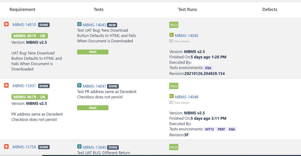

Location: Xray Traceability Report
Questions:
1. The Requirement Test Status results for the Xray Traceability Report appear to be the same as the Requirement Test Status Results displayed in the Overall Requirements Coverage Gadget (Requirement Test Status 2 above). Do the Gadget and the Report use the same criteria and algorithm to calculate the results shown in each?
If not, we have the same questions about the calculation of Requirement Test Statuses for the Xray Traceability Report as we have for the Overall Requirements Coverage Gadget:
1.1     Which Tests linked to each Requirement does the Xray include in its calculation of the Requirement Test Status shown in the Xray Traceability Report - all linked Tests or only those Tests linked to the Requirement via a “Tested by” link?
1.2     Does Xray only look at the Test Plan specified in the Test Execution or does Xray also check that the Test itself is associated with the specified Test Plan? (I.e., how does the Xray treat a case in which a Test itself is not associated with the specified Test Plan but one or more of the Test’s Test Executions are associated with the specified Test Plan?)

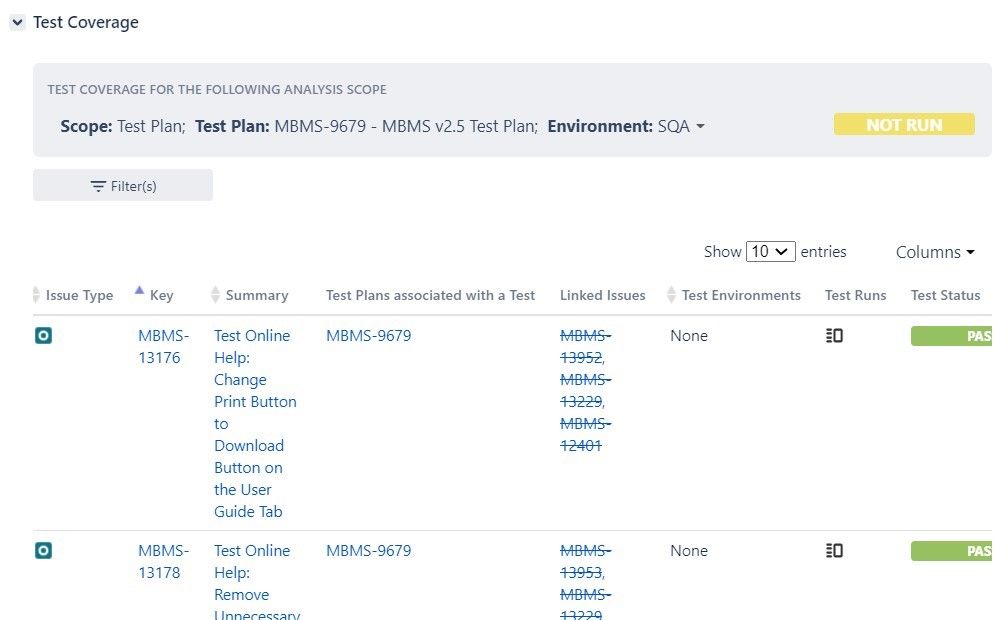

Location: in the Summary bar at the top of the Test Coverage Panel in a Requirement (Story or Test) Issue
We have experienced cases in which the Requirement Test Status shown in the Summary bar at the top of the Test Coverage Panel in a Requirement Issue displays a Requirement Status that is inconsistent with the actual Test results that contribute to the Requirement Test Status.
The example above is one such situation:
  • The Requirement Issue (a Story) is linked to seven (7) Tests via seven (7) “Tested by” links.
  • Four (4) of the linked Tests are in the specified Test Plan; three of the linked Tests are associated with a different Test Plan.
  • All four (4) of the linked Tests in the specified Test Plan Passed in the specified Test Environment. All four (4) of these Tests are shown as Passed in the Test Coverage Panel list below the Summary bar; the remaining three (3) Tests, which are not associated with the specified Test Plan, are shown as N/A in the Test Coverage Panel list.
  • Additionally, an Overall Requirements Coverage Report that was run using the same Test Plan and Test Environment as that shown in the Test Coverage Panel above indicated that this Requirement Passed four (4) of a total of four (4) Tests. When the “4” in the Total Tests list was clicked, the result listed the same four (4) Tests shown in the Test Coverage Panel, which all have a Status = Passed. (I.e., the Overall Requirements Coverage Report correctly included only the four (4) linked Tests that are associated with the specified Test Plan and Test Environment; the three (3) linked Tests not associated with the specified Test Plan were ignored.)
  • Given the set of circumstances described above, we expect the Requirement Status shown in the Test Coverage Panel Summary bar to be “OK”, yet the Requirement Status shown in the bar is “NOTRUN”.
Question:
Why is the Requirement Test Status shown in the bar at the top of the Test Coverage Panel above “NOTRUN” instead of “OK”?
