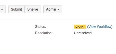

When transitioning a sub-task, which has required fields, from "draft" to "submit", validation of required fields does not work on pages other the "edit" screen.
It only works when I click on "edit" and hit "create." Then, I will get a list of required fields that need to be entered to continue.
How can extend this type of validation beyond the "edit" screen, so that when I transition a subtask, by hitting "submit" on the view screen, it checks to make sure all required custom fields are filled?

HOWEVER, when I simply transition the SUBTASK from "draft" to "submitted on the VIEW SCREEN, (not the edit or create screen), it allows me to transition the issue without validating the required fields.
I want it to check for required fields BEFORE transitioning.
I added a field set validator on the transition on the subtask workflow.
While it works. The problem is it checks for the specified field all the time regardless of whether or not I'm trying to transition another subtask that does not include the specified field.
I need for each of the subtasks to check to make sure all of its required fields are filled in before transitioning, just like it does on the edit and create screens.
