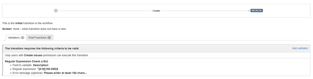

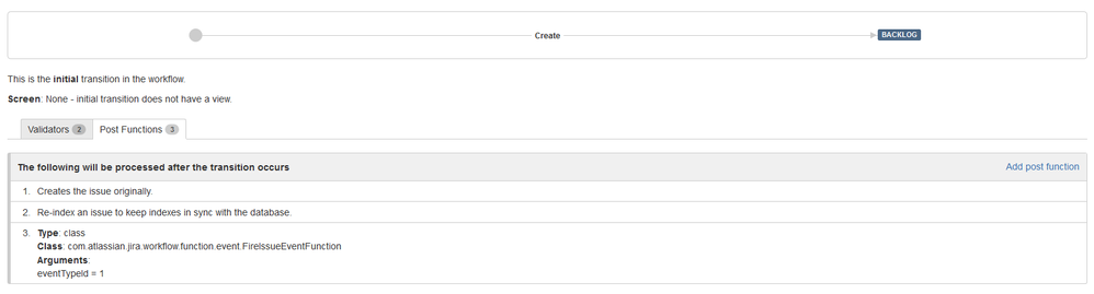

Hmm.. The error seems similar to this problem - https://confluence.atlassian.com/jirakb/can-t-create-issues-due-to-script-runner-for-jira-being-disabled-899429413.html . Are you using Script Runner for JIRA plugin? If not could you share screenshots from your workflow configuration (validators and post functions) on the transition that you would like to validate?

Could you then share screenshots from your workflow configuration (validators and post functions) on the transition that you would like to validate and create screen? Any errors in the JIRA logs?
