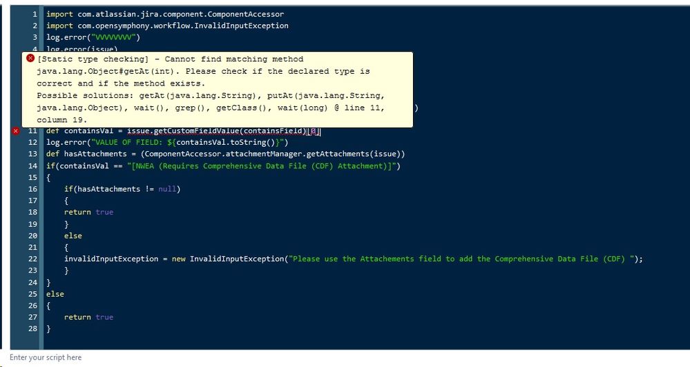

Eric Smith
March 5, 2019

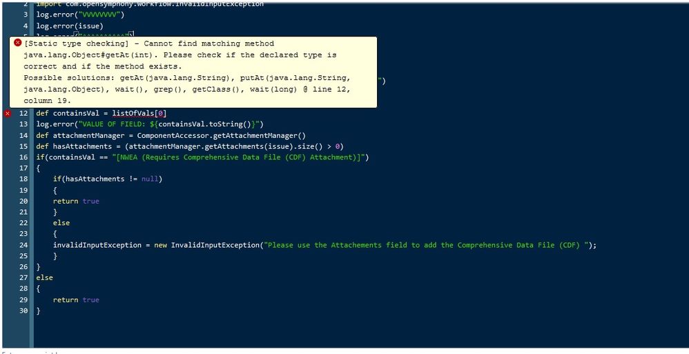

When I add the line
def containsVal = issue.getCustomFieldValue(containsField)[0]
It wont work. I get a red "x". I tried to add it like

March 5, 2019
For containsVal, replace
with:
The [0] is indicating the first item in the list (even if the list only contains one item).

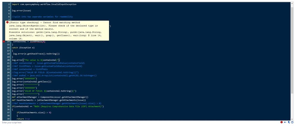

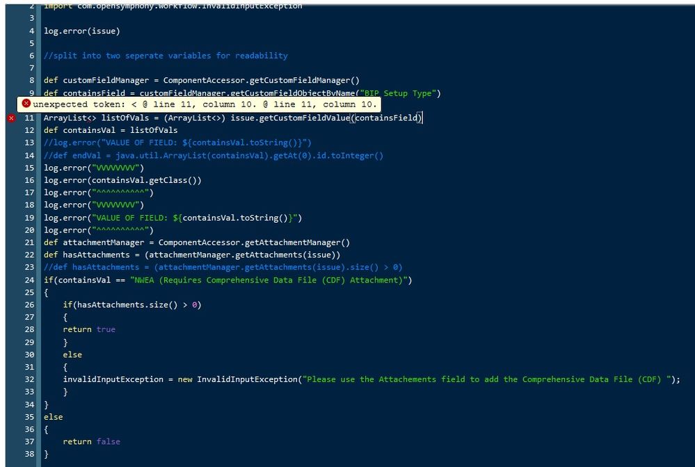

Eric Smith
March 5, 2019
When I put in the [0] this is what I get:
attach_error.jpgAs far as the logging is concerned, I added the requested lines above and below log.error(issue) and here is what I got:

Eric Smith
March 5, 2019
Still getting an error when values is [0]. See screenshot:

Eric Smith
March 7, 2019
Same error, definitely doesnt like the integer at the end:

Sorry, just saw this, been a busy week. Try changing
def listOfVals = issue.getCustomFieldValue(containsField)
to
ArrayList<> listOfVals = (ArrayList<>) issue.getCustomFieldValue(containsField)
Eric Smith
March 15, 2019
Different error, im not sure what you are trying to do with that line:
