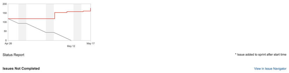

In Reporting, for previous Sprints I see no "Completed Issues" in the Sprint or Burndown chart. This is despite the fact that many tickets were completed during the sprint.

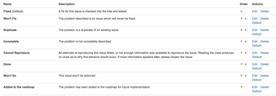

My workflow and resolutions:

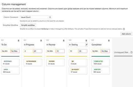

My board setup:
Sprint Report Example- Notice no "Completed Issues" section.

I have done as advised and made sure all boards that view tickets for this project have those status mapped to the last column.

Are there more boards which display those issues?
If that's the case, do all of them have the 'Completed' and 'Sign Off' statuses mapped to the most-right column? This would be a typical cause of story points not being burnt.
