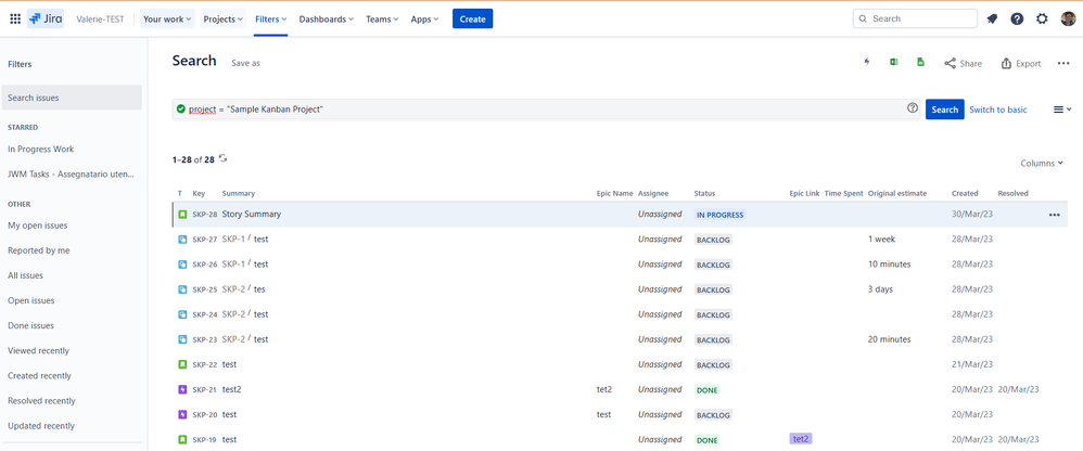

I think if you are interested in the elapsed time from when a Jira issue is opened to when it is closed, this should be a relatively straightforward query in the Jira query language, JQL.
You can request a query be written in JQL, for the project, something like this, and then ask to add the two columns for the Created and Resolved date.
It is possible to ask for these results to be emailed to you as a report periodically, using a filter subscription. From that, you can put the data into Excel or another tool to do the date comparisons.

You can write this type of query in any hosting of Jira, cloud / server / data center, and the filter subscription function is also available in any of the hostings.
The created and resolved dates are system fields and so these should also be migrated and maintained. If, for example, an issue is opened in Jira server, let's say, and then migrated to the cloud, where it is resolved, you should still be able to report on both dates.
