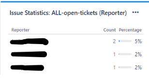

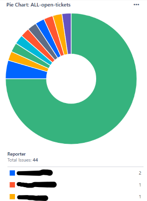

You can create a filter to get all the issues of interest and save this filter. If you need help with this filter creation, please send a message back. Now, on the dashboard, you add a gadget, which is either an 'Issue Statistics' or a Pie Chart (which is what you mentioned as your preference). In either of these gadgets, you will use Reporter as the Statistic Type and the saved filter as the Filter. Adding a couple of screen-captures for your reference.

Cameron Tau
September 16, 2018
Hi Kalyani,
Thank you for that info, I was not aware of the issue filters or how much you could customise the dashboard, this covers a lot of other things I need at the same time!
