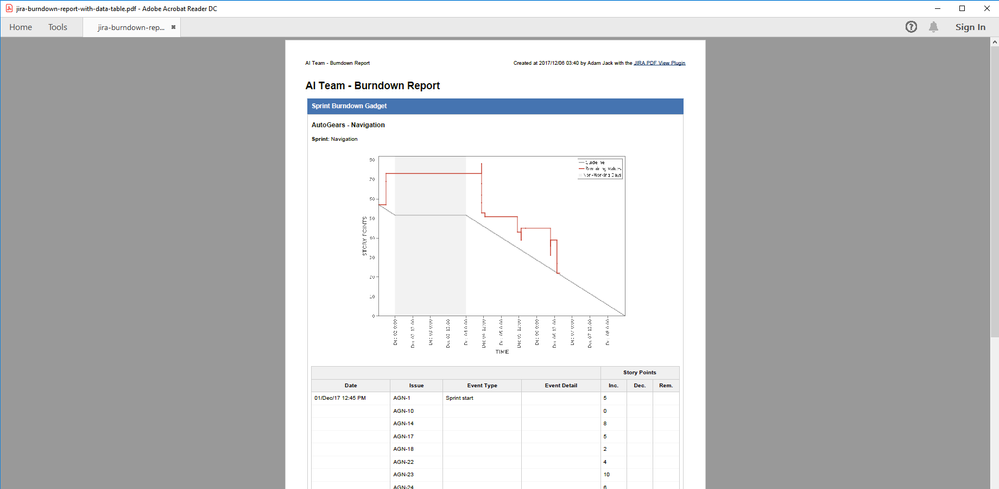

I think you can see all events that affect the sprint in the Burndown Report.
You can even export that to PDF using the Better PDF Exporter app (sample):
Hi,
It seems burn-down report also give detail about issues added after sprint start. This information also useful.
It is really appreciated.
