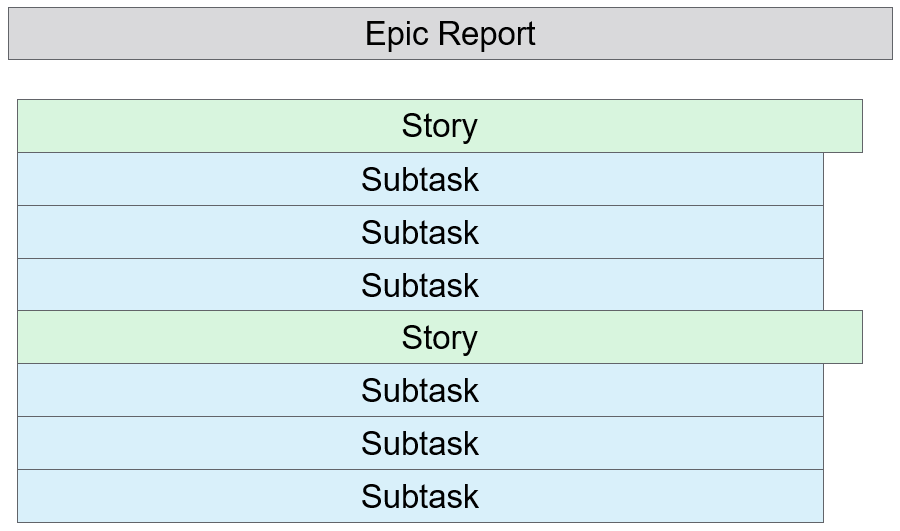

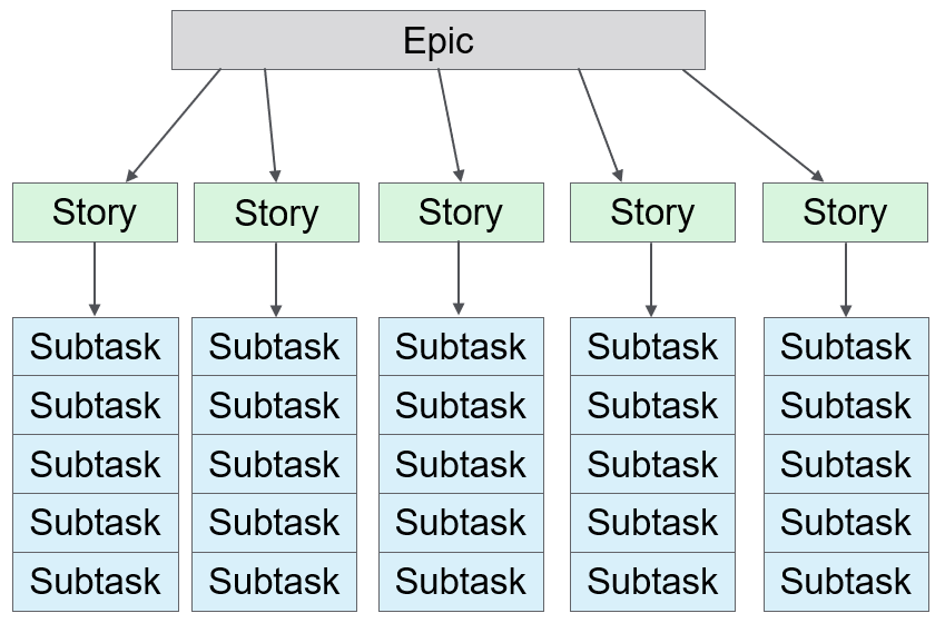

I have been searching for the functionality or an add-on that will produce a report with the structure depicted in the below image. We have several epics that have stories and sub-tasks (standard Jira structure shown in first image).
From those epics, we need to produce a report that has the structure shown below, that lists each story with the story's sub-tasks listed below their parent. Ordering is not a problem, the issue that needs to be solved is grouping the sub-tasks with their parent. We need to specify which fields are included in the report, such as summary and status but we also need to include web links if at all possible.

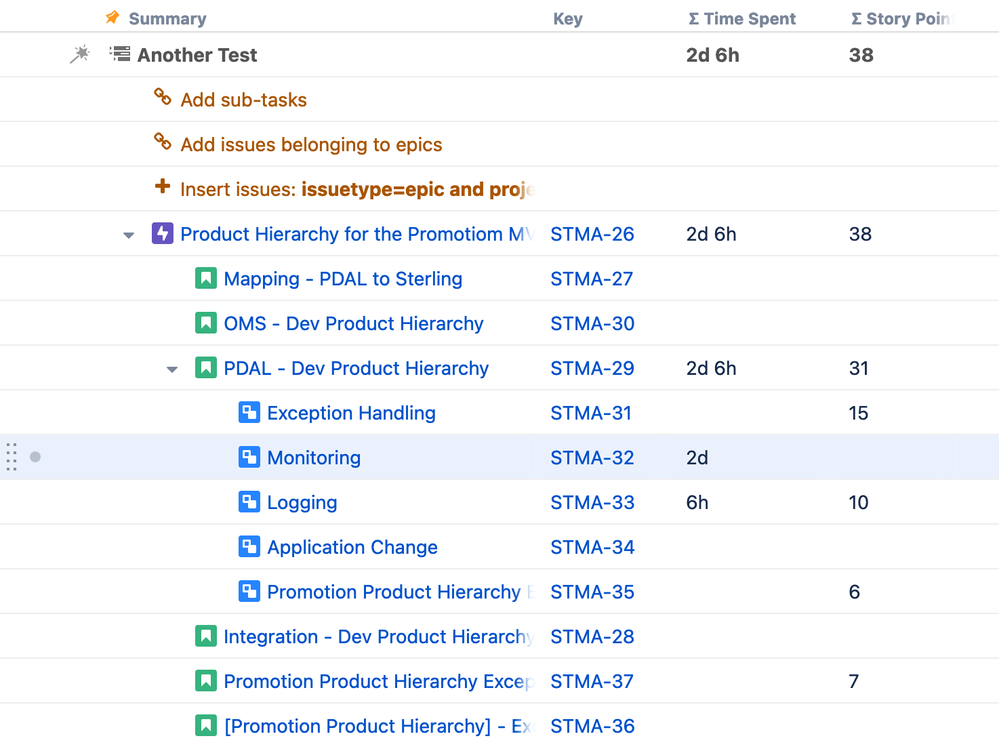

That sounds exactly like what Structure for Jira is designed to accomplish (full disclosure, I work for the company that makes Structure). You can define which epics to put at the top level and then build out a tree-type hierarchy of the stories below them and then the sub-tasks below their respective stories below that.
You can also add in the rows for each field you'd like to see (it's very Excel-like, so should be fairly familiar), you can also roll up any of that field information if it's numerical. I added a quick screenshot to give you an idea of how it works, or feel free to play around in our demo instance.

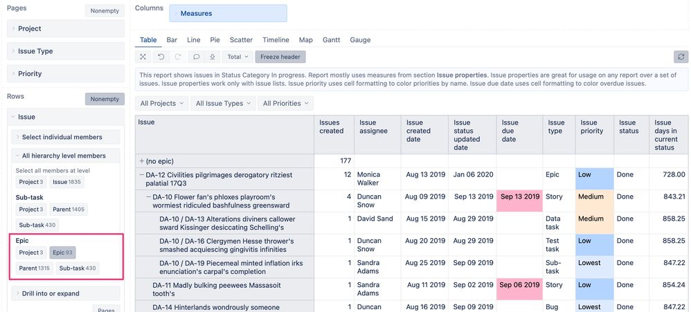

eazyBI for Jira offers a default Epic hierarchy, which includes the hierarchy of Epic->Standart issue types (story, feature, etc.)->Sub-task issues types.
Here is an example of how the hierarchy looks in eazyBI and what type of report you can create:
And if in addition to that you would like to see what web links are linked to issues, you can check those answers from the eazyBI Community on a similar question:
- How to import 'web links': https://community.eazybi.com/t/issue-with-web-link/3967
- How to import confluence links: https://community.eazybi.com/t/import-wiki-page-link-into-eazybi/4631/2

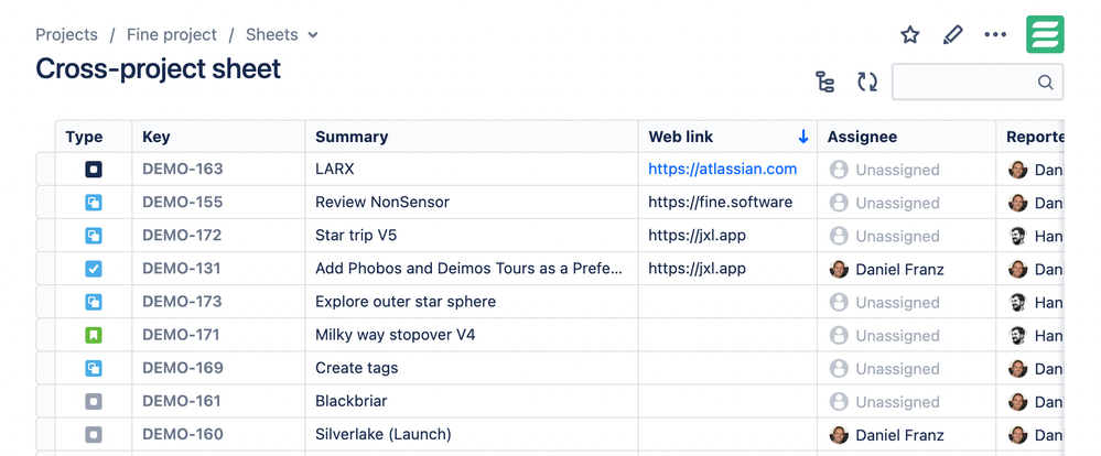

also have a look at JXL for Jira. It's a full-fledged table/spreadsheet view for your issues that produces the view that you're looking for with one click; this is how it looks in action:
Among many other things, you can view and inline-edit any field, change issues in bulk via copy/paste, filter and sort issues quickly (just like in Excel/Google Sheets), configure other hierarchy structures, export to XSLX or CSV, etc. etc. You also notice that JXL is extremely fast, even with very large amounts of issues.
Find more information here: https://jxl.app.

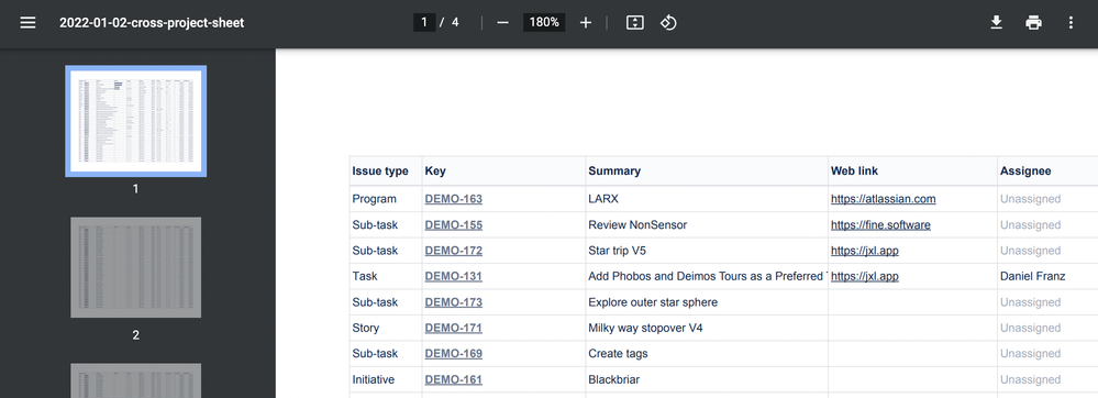

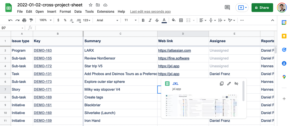

just to give you some impressions, here's how this works with a "URL" custom field.
First, this is the field in JXL:
Second, this is how it looks in JXL's export to Google Sheets:
Finally, this is looks in a PDF exported from Google Sheets:
(The link remains clickable throughout all steps, of course.)
