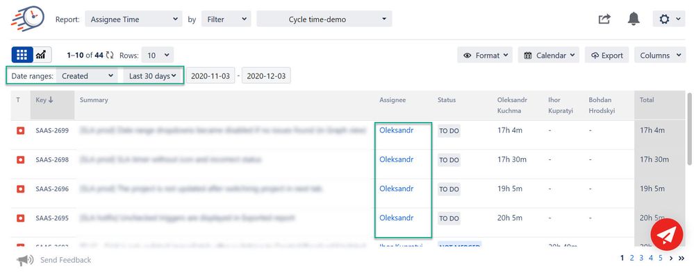

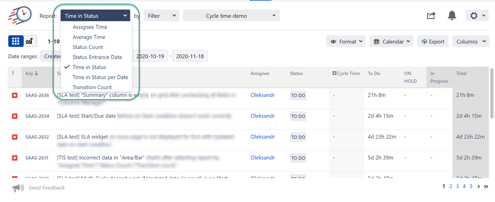

Or as an alternative,  try a third-party add-on developed by my SaaSJet team - Time in Status for Jira Cloud.
It doesn't show logged hours but generates 7 types of time reports (it's helpful in your case too). Time in Status report shows how long an issue has been spent in each status. So you can get to know how long it takes to solve each issue.
Assignee time report shows how long a particular assignee has been assigned to each issue. It helps to understand the duration of issues resolving. Then you can export these reports as  XLSX or CSV files for further analysis.

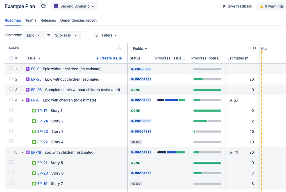

I did some experimentation and not everything seems to tally with exactly what you've described:
The progress doesn't seem to always show as done for epics without children, but rather reflects the logged ours on the issue.

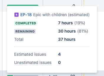

I do agree that the relationship between the "Estimate" field and the time tracking field on the issue details screen is not completely intuitive. When you initially set the estimate on an unestimated issue it will set the original estimate, and when time is logged via the issue it will be reflected as progress on the plan. Where it gets confusing is when you then adjust an existing estimate from the plan as this will extend the remaining time.
The pop-up is intended to reflect the overall progress of the epic and its children (rather than just the epic itself)
It sounds like this is not what you're expecting, but rather you just want the progress information to be related to just the epic itself?

Your testing will better match what I'm describing if you leave the Original Estimate and Time Remaining fields blank. That's what I meant by "we are not estimating".
I realize that one common use-case for Roadmaps is for "planning". But our hope was that Roadmaps would also have value for "tracking" (independent of estimation). The latter is where we were disappointed.
