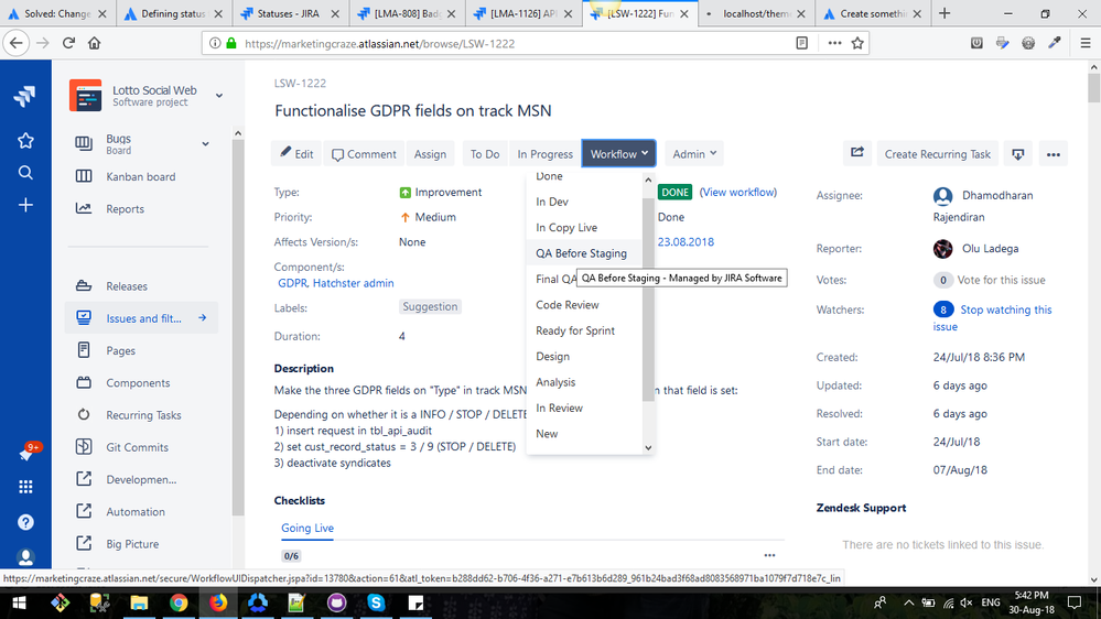

How to reorder the workflow status? please refer screenshot.

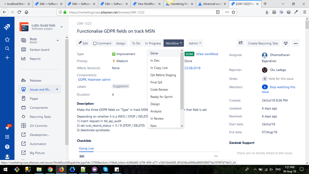

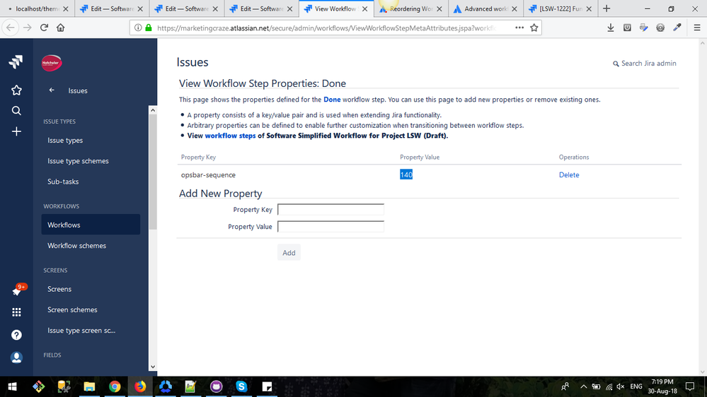

@Bastian StehmannI have tried to add 10, 20, 30 and so on up to 140 to opsbar-sequence.
Added 140 to 'DONE' but still it's showing as a first option in workflow. I published draft workflow. Please refer the screenshot below.

Hi @Dhamu,
it seems that you added the property to the status. You have to add the property to the transitions (the outgoing arrows).

Hi @Bastian Stehmann. I am new to the jira so not able to differentiate what is status or transitions. Please see the below screencast how I edited.
https://www.screencast.com/t/DIvELevkf4
Dhamu
August 31, 2018
Hi @Bastian Stehmann. Thanks. After set the property in transitions it's working fine. Great help. Appreciated always. Thanks
