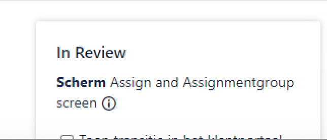

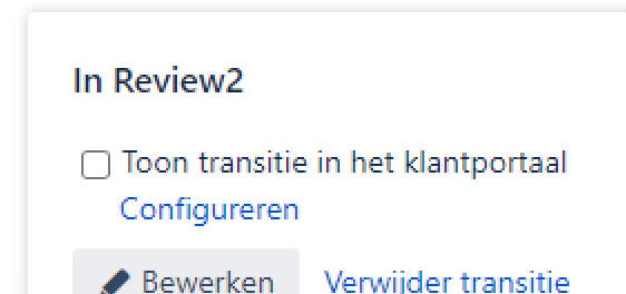

Regarding your situation, I have tried to recreate the situation on a Server environment. When I rename the transition, the popup screen of the transition is then shown without mentioning the transition screen.
But if I publish the change immediately, the transition screen appears to be properly linked.
Are there adjustments be made to conditions or validators after changing the name?
Regards, Marco
P.S. Hereby 3 screenshots of the name change of transition from In Review to In Review2 (my. Jira is set to Dutch language)
Screenshot 2023-06-22 at 13.59.59.pngScreenshot 2023-06-22 at 13.59.39.pngScreenshot 2023-06-22 at 13.59.29.png

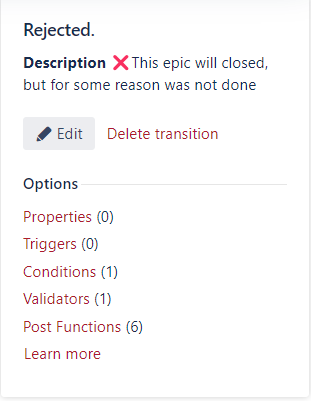

Hi @Marco Brundel
No conditions, validators, Post functions are changed after publishing.
Interesting part is that I don't encounter such behaviour myself because I'm Jira Admin.
Only project admin user has this problem. Screen is not there after the renaming.
 2023-06-26 17_30_10-Workflow - BB-FF-Epic-Workflow - Sportradar JIRA and 7 more pages - Work - Micro.png
