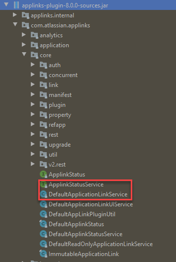

Adaptavist support only mentioned that com.atlassian.applinks.applinks-plugin have less modules (94 instead of 127) but I have jira code downloaded and DefaultApplicationLinkService is still under:
com.atlassian.applinks.core.DefaultApplicationLinkService in applinks-plugin-8.0.0-sources.jar file.
What more, Code Completions in scriptrunner works and I can see and pick methods from DefaultApplicationLinkService .
also I've try with other class in this jar:

and this worked, what is the difference between DefaultApplicationLinkService and ApplinkStatusService? location is almost the same:
Any idea why this import stopped working and how properly import DefaultApplicationLinkService?
