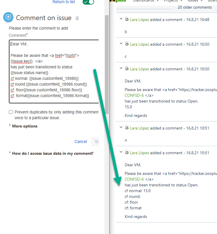

Lara Lopez Garcia
August 16, 2021
Thanks Bill, but none of them worked :(.
BR
Bill Sheboy
August 16, 2021
Interesting... I rechecked and all of those functions work as documented for me.  Please note that for format() you need to provide a format string, such as .format("#")
And, I noted you are using Server version, so let's try this syntax:
{{#=}}FLOOR({{issue.customfield_18986}}){{/}}
