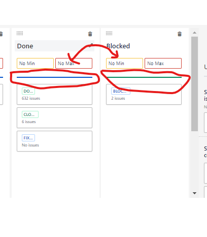

I set up a board in a bad way so that the DONE status will not be in the last column (green column), and an issue with a DONE status is not seen as a finished task.

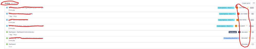

This caused issues in DONE status, move to the next sprint, and if I removed them from the sprint, they moved to the backlog even they were resolved.
After I fixed the DONE status and set it to finish the sprint, how can I remove all finished tasks from the next sprint and from the backlog without using a filter ("ststus != done" or any similar filter)?

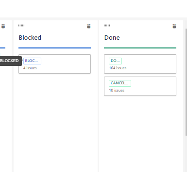

Yes that's what I did. The question is how after I have changed I can remove the completed issue from backlog without filter?
Nic Brough -Adaptavist-
March 1, 2023
You can't do this without using a filter.  The filter is what a board (and it's backlog) are defined by.
Your only option is to take the issues you made (re)opened in the board when you changed the definition of done into a sprint and move them straight into the done column to tell Jira that they are done again.
