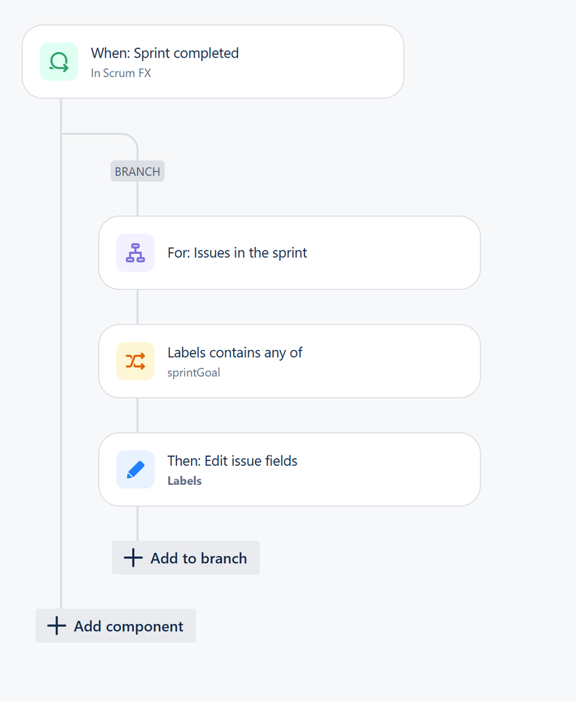

My current automation looks like this

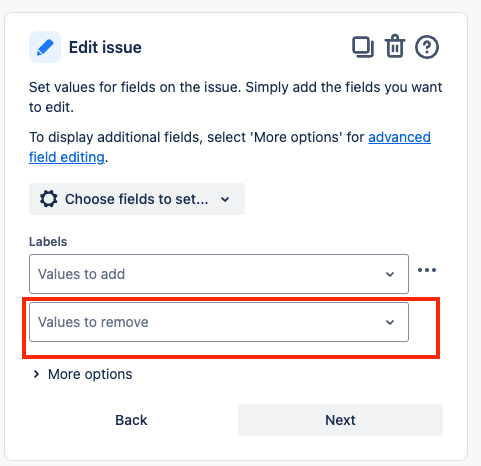

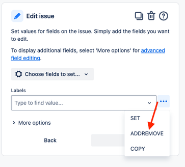

In the Edit action, after selecting the Labels field click the ... button to the right of the Type to find value... field and select ADDREMOVE
You can then specify the Labels value(s) you want to remove in the Values to remove field.

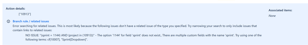

I have it, but it is not working. In the audit log there is an information about some errors.Remove sprintGoal label error audit log.png
Trudy P Claspill
October 9, 2024

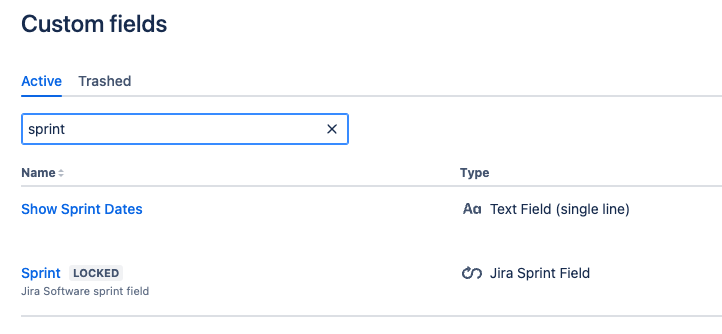

The root of the problem, as mentioned in the error message, seems to be that in your instance there are multiple custom fields named "sprint" so the branch portion of the rule is unable to zero in on using the native, Jira-provided Sprint field to find the issues in the sprint that was closed.
The one that you need is the one that is Locked and of type Jira Sprint Field
I recommend that you look into that to determine why there are multiple custom fields with that name. Note that Jira doesn't require custom field names to be unique.  It is possible that a such fields have been created by Product Admins at the global level under Settings / Issues / Custom fields, or created by Project Admins in Team Managed projects.
I advise that you work to get any other custom fields also named Sprint renamed, and then your rule should work.
