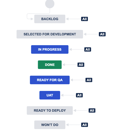

Then you would click on the Create transition (between the circle and the Backlog lozenge) to highlight the transition (1). Then click and hold on the point where the Create transition touches the Backlog lozenge (2).
Then drag that point to the new status lozenge labeled "To Do". That will make all newly created issues start in the To Do status.
Then you can delete the Backlog status from the workflow.
After creating this new workflow you would update the Workflow Scheme associated with the project. You would add this new workflow and specify the types of issues to which it should be applied.
During that process the wizard will ask you to specify the status that should be set for all issues that are currently in the Backlog status, since that one will no longer exist.

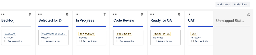

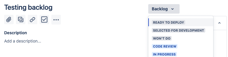

ivana.gruszka
December 19, 2022
Thank you! I was thinking this would be the approach, I was afraid about impacting the current tickets on Backlog.
I am totally OK with having a column in To-Do in the current sprint!
ivana.gruszka
December 19, 2022
Screen Shot 2022-12-19 at 15.20.25.pngScreen Shot 2022-12-19 at 15.19.48.pngScreen Shot 2022-12-19 at 15.19.26.png
