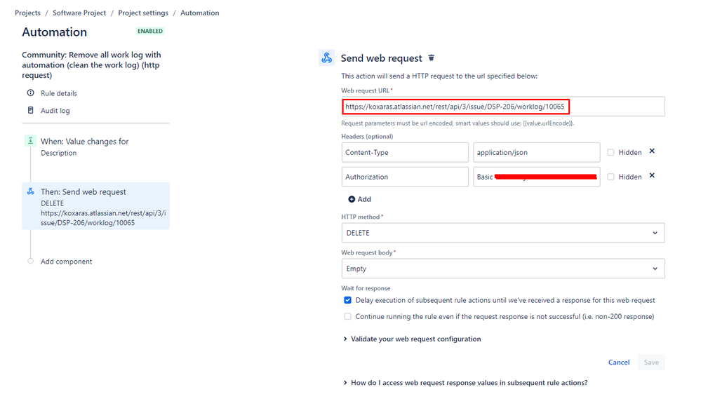

To answer to your reply, the endpoint you have to use to delete a worklog is:
https://yourdomain.atlassian.net/rest/api/3/issue/ISSUE_ID/worklog/WORKLOG_ID
and not /rest/api/3/issue/{{issue}}/worklog
You can't delete all worklogs right at the get go. You have to provide the worklog id and then delete a specific worklog. I've tried on my instance the above endpoint I mentioned and everything works fine.

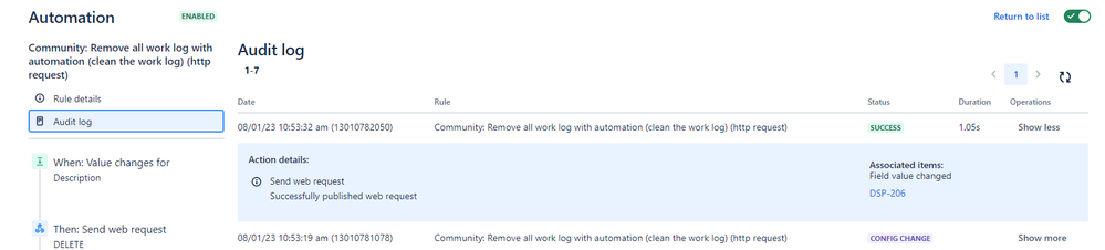

And finally I’ve found this article : https://community.atlassian.com/t5/Jira-Software-articles/Delete-all-worklogs-from-an-issue-using-Jira-Automation-with/ba-p/2233207.
I may have a try on this one !
Yup, I wrote it based on your question :)

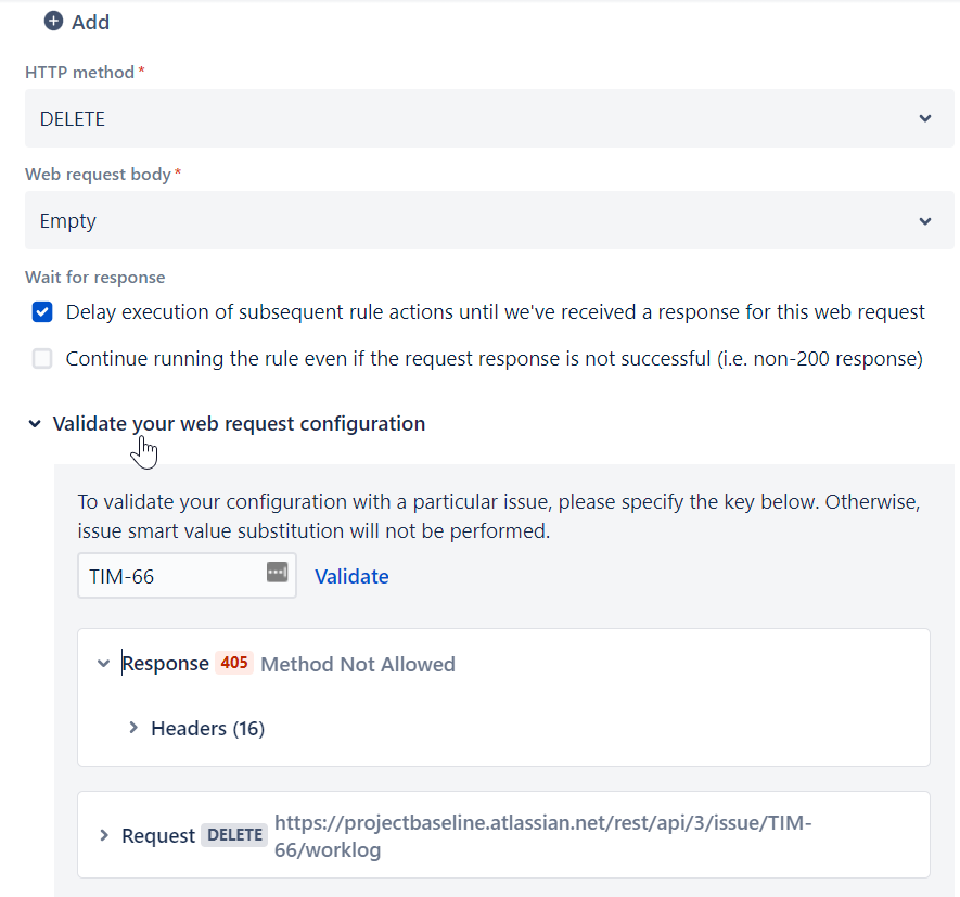

I'm using the https://projectbaseline.atlassian.net/rest/api/3/issue/{{issue}}/worklog endpoint and it seems not accepting Delete method to kill all the worklog.
https://developer.atlassian.com/cloud/jira/platform/rest/v3/api-group-issue-worklogs/
when I use the endpoint on Automation I get wrong method response.
I think there no way to delete all worklog at once.
