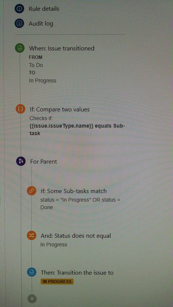

yaro137
September 16, 2021
Here it goes. No mention of changing Assignee.

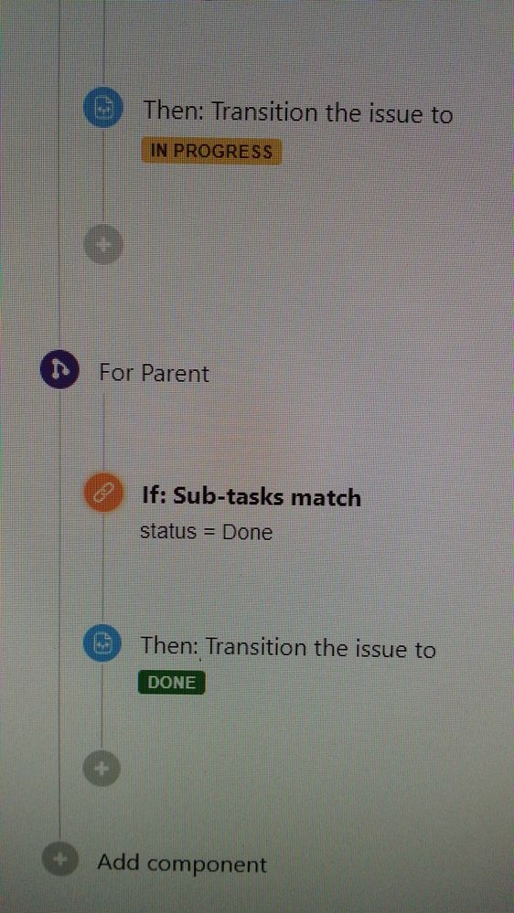

yaro137
September 16, 2021
The reminder is only to mark an Epic Done if all Sub-tasks are Done.

It doesn't look default in my case. I stopped the rule and I see lots of Epics with To Do status yet their subtasks are In Progress or even all Done. I have no action set to change the assignee in my rule so the only explanation can be that it uses the Actor account to make the modification and so it changes the assignment. I see this happen every time the rule succeeds running transition step. So first under for Parent it checks if some Sub-tasks status match In progress or done and issue status does not equal In Progress then it transitions the issue to In Progress. Perhaps what I need can be done in workflow as you mentioned but if so I have not a clue how.

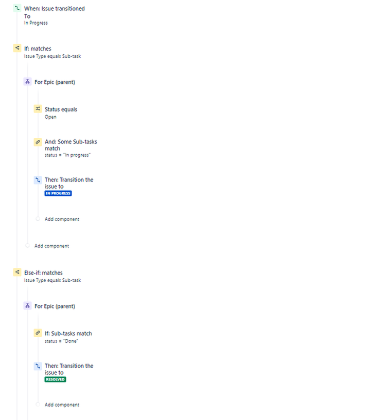

Also, I see you "complicated" the automation a bit, this one should perform faster.
