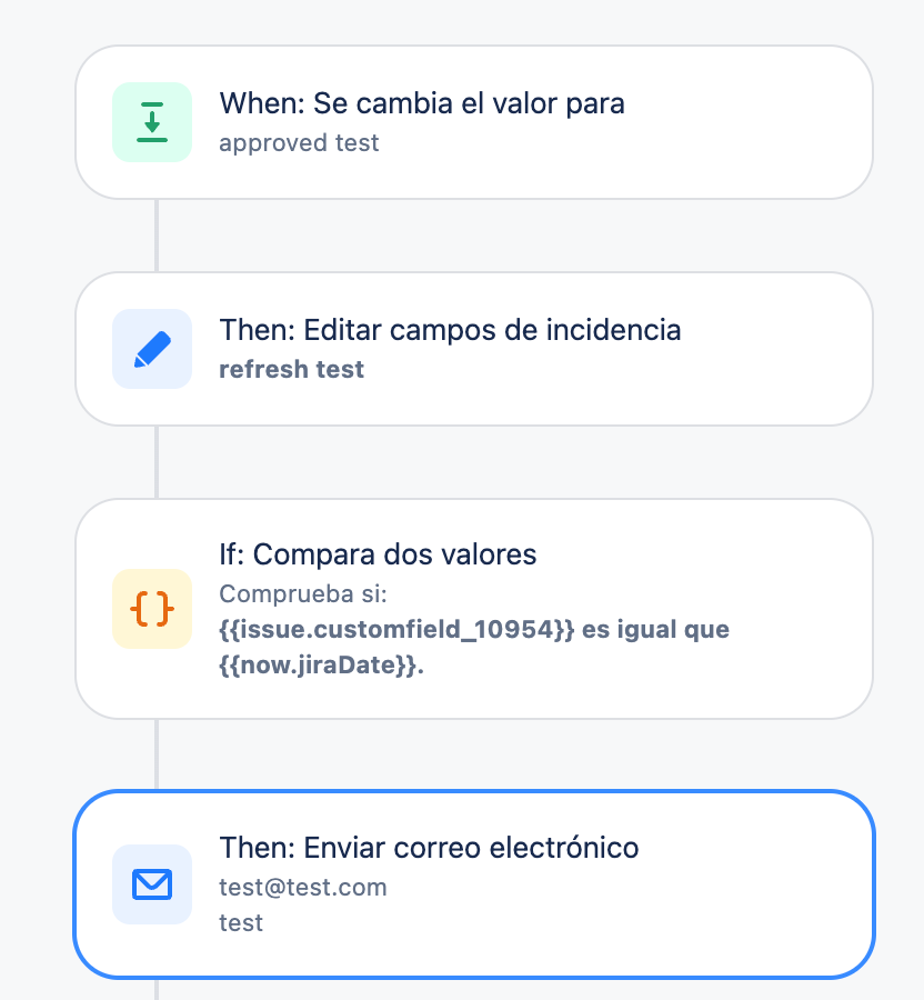

I created an automation for when I add a date in the ''approved test'' automatically the field ''refresh test'' change to 15 days later and it works correctly, now, I want to add that based on the date (the 15 days later) that day I get an email notification and I would like to add in addition to that some conditional that if before that time the ticket changes to status ''finished'' no notification is sent. What would be the best way to do it?
Here's the way that I was trying to make it:

You can't add the email reminder activity to the same rule. The rule you have is triggered by a change to the approved test field. It will attempt to send the email the same day the rule is triggered. There is no method available within a rule to tell the rule to schedule an email to be sent later.
You need a separate rule concerning to send the email.
I recommend that you use a Schedule trigger for the second rule. You can set it up to run daily and execute a JQL to find all the issues where the the "refresh test" date is the same day and the issue is not in the "finished" status:
"refresh test" is not empty and "refresh date" = now.jiraDate and status!="finished"
Then add an action to Send Email. This will execute for each issue found by the JQL in the trigger.

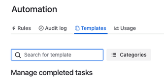

Trudy P Claspill
January 3, 2025

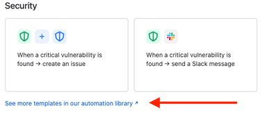

For future reference, when you go to the Automation page there is a tab for Templates. You can look there for examples.
Additionally on that same page is a link to an online area that has more templates:

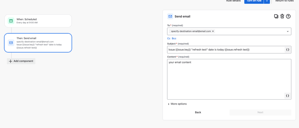

Here is an example of a rule that could work.
The JQL used in the schedule trigger is
"refresh test" is not empty and "refresh test" >= startOfDay() and "refresh test" <= endOfDay() and status != "finished"
You can build out that JQL in the Search for Issues screen to confirm you have specified the field names and Status value correctly.
That will return all issues where "refresh date" is the same day that the rule runs, and the status of the issue at that time is not "finished"
Make sure that you uncheck the box below the JQL. With it check the rule would process only issues that had some update since the last time the rule ran.
Then you add an action to send the email. An email will be sent for each issue found by the JQL.

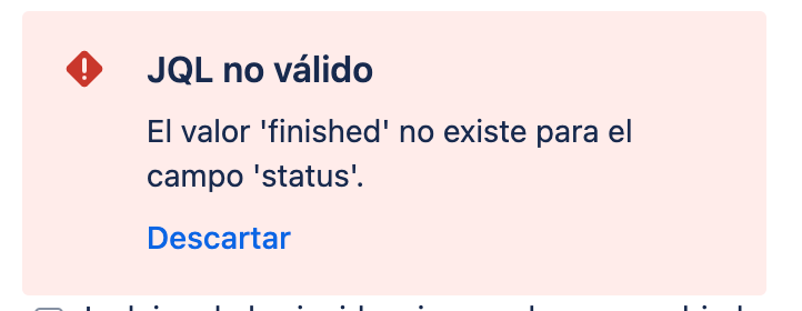

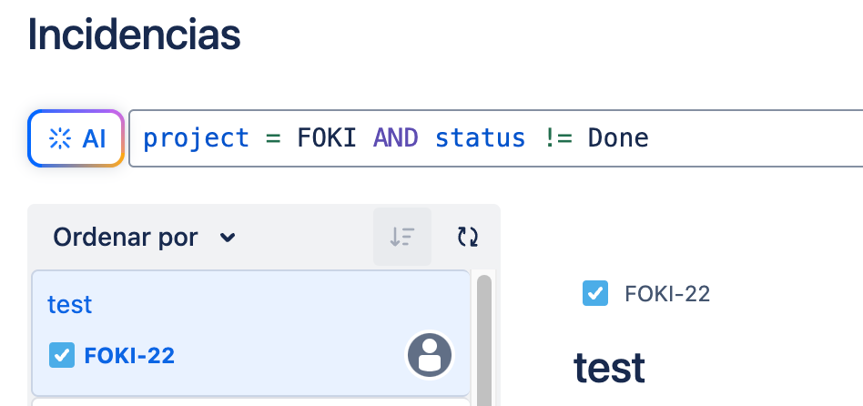

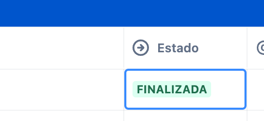

Just las thing, I was trying to create the JQL but got an error message:
tried to change the names to spanish but got the same error, this is the field:

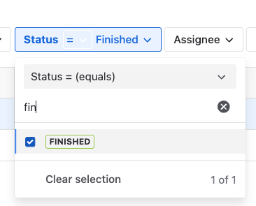

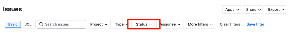

Trudy P Claspill
January 3, 2025

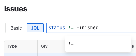

Use the Search Issues screen to create that part of the filter. You can start in the Basic view:
Pull down the Status field. Select the value from the list.
Then switch the the JQL view and add the "!" character so that the criteria is "not equal" instead of "equal"
That will give you the valid JQL syntax for the Status criteria.
If that doesn't resolve your issue, please provide a screen image (or copy the text) of your entire JQL statement and share it with us.

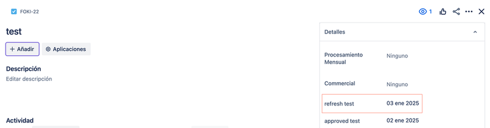

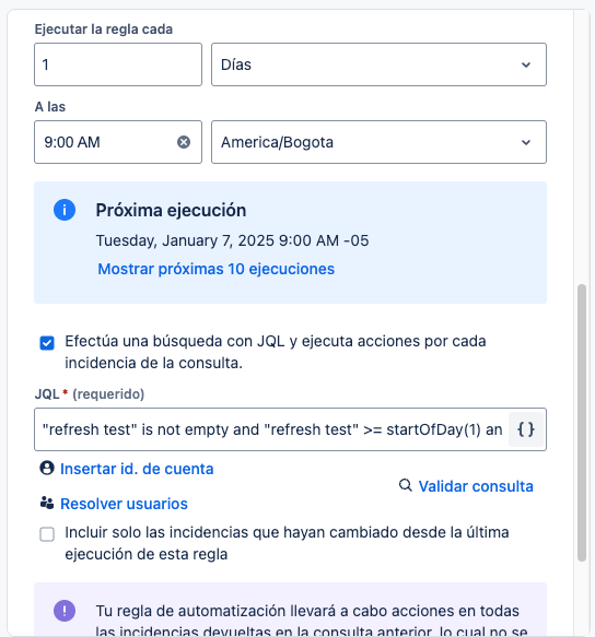

I already set up the automatization and leave with 1 day to test, however, I don't receive the notification, could you please help me letting me know If I did something wrong?
This is the JQL: "refresh test" is not empty and "refresh test" >= startOfDay(1) and "refresh test" <= endOfDay(1) and status != "Done"
This is the search issues screen to double check: ticket (FOKI-22)
And this is the refresh test date January 3

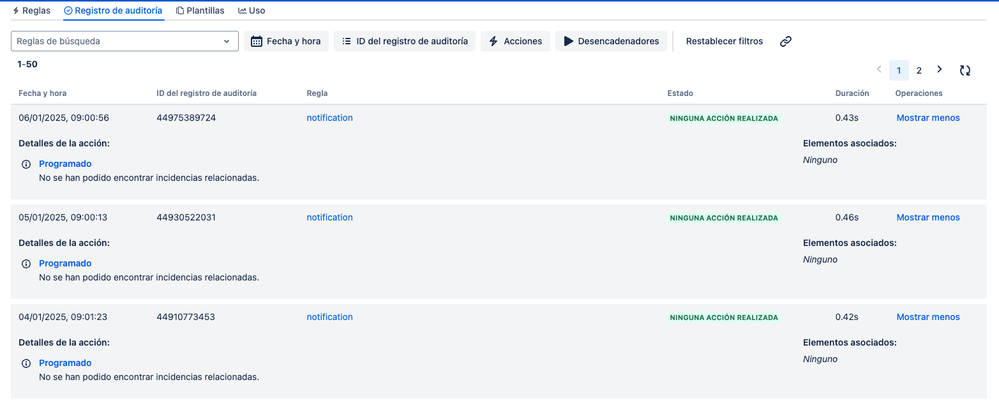

Please provide screen images that show
1. your entire automation
2. the details of each step in the automation rule
3. the output in the Audit Log for when the rule executes.
4. the information in the Rule Details page
5. The details of an issue for which you think you should've gotten an email

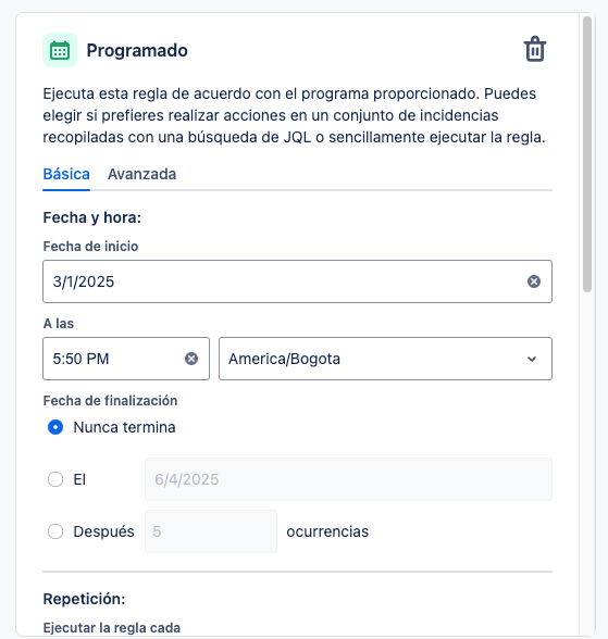

Felipe Motta
January 6, 2025
Captura de pantalla 2025-01-06 a la(s) 5.54.43 p.m..pngCaptura de pantalla 2025-01-06 a la(s) 5.55.36 p.m..pngCaptura de pantalla 2025-01-06 a la(s) 5.55.50 p.m..pngCaptura de pantalla 2025-01-06 a la(s) 6.01.06 p.m..pngCaptura de pantalla 2025-01-06 a la(s) 10.20.51 a.m. 6.08.31 p.m..png
Trudy P Claspill
January 6, 2025

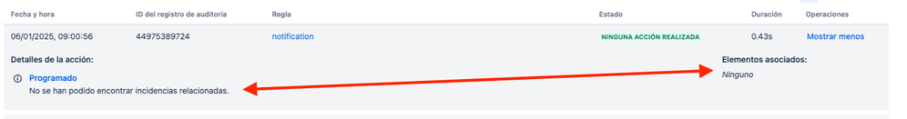

The log is indicating that there are no issues being found that match the JQL in your trigger.
What is the complete JQL that you have used in your Scheduled trigger?

This one: "refresh test" is not empty and "refresh test" >= startOfDay(1) and "refresh test" <= endOfDay(1) and status != "Done"
When exactly do you want to get the notification compared to the date specified in "refresh test"? Do you want to get it on that same date? Do you want to get it some number of days before that date? Do you want to get a reminder if that date is in the past?
In the example I provided I had no number in the parentheses for startOfDay() and endOfDay() which would result in the email being sent on only the same date as "refresh test"
When you use startOfDay(1) and endOfDay(1) you are telling Jira you want to compare against "start of today plus one day" (i.e. tomorrow's date) and " end of today plus one day" (i.e. tomorrow's date.
Looking at the audit log the rule ran on
4 January
5 January
6 January
The "refresh test" date in the issue you showed 3 January.
3 January is not "tomorrow" relative to any of the dates on which the rule ran.
When it ran on 4 January it would've selected issues with a "refresh test" date of 5 January.
When it ran on 5 January it would've selected issues with a "refresh test" date of 6 January.
When it ran on 6 January it would've selected issues with a "refresh test" date of 7 January.
When you specify when you want to actually receive the notification, I can offer a suggestion about how to change your JQL.

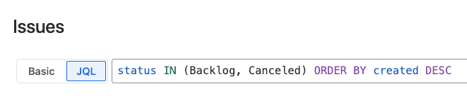

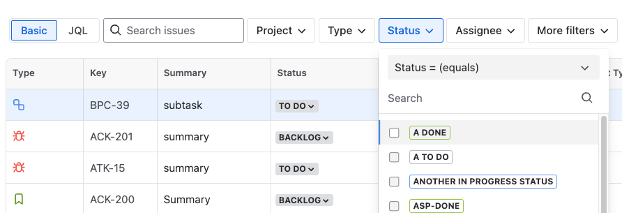

Trudy P Claspill
January 8, 2025
Hello Felipe,
As I mentioned before, you should use the Issue search screen to work out the proper JQL syntax.
Try to put the same JQL into the issue search screen to see if it is valid. Get to that screen by going to the Filters menu and selecting View All Issues. You may have to change the query building method from Basic to JQL if that option is not already selected.
If you are unfamiliar with how to build queries with JQL, I recommend that you start by using the Basic interface. There it provides pull-down fields to help you build up your query. You can then switch the the JQL interface to see how that looks in JQL. Not everything that can be done in JQL can be done in the Basic view.
You can search for fields to add:
After selecting it, Jira will give you some prompts for criteria and/or values to select.
Some fields, like Status, are already available.
For that field, check the boxes for all the status values you want to include.
Then switch to the JQL view to see what that looks like in JQL.
