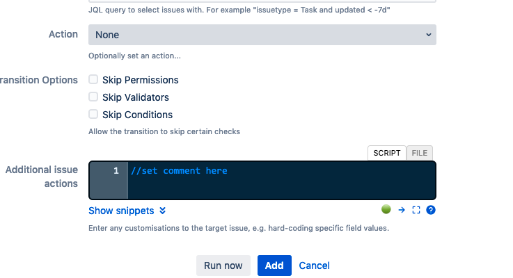

I tried Escalation service. But, the requirement is "Status shouldn't change" and "Assignee should be notified" about the issue. Which should be similar to SLA in service desk.
BTW we are on Data center and have only ScriptRunner.
Kian Stack Mumo Systems
February 15, 2021
@Anil, what exactly the problem with using escalation services, if you don't mind explaining? Using Escalation services try doing the following:
February 15, 2021
To set a comment, you can use the code
issueInputParameters.setComment('Write your comment here')

That worked. Thanks Kian
