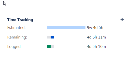

Hello Danielle,
Can you please provide us a screenshot of the view you are referring to? Are you using the new issue view or the old issue view?
Normally, the time Tracking is displayed in three fields of the issue view or in a single one displaying the logged time against the remaining.

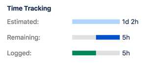

Old issue view:
New issue View:
Can you please let me know if you do not seem this field like this?

We are using the Old Issue View and that is a great example of what I am seeing.  I would expect to see that remaining would be = to the Estimated - the logged.  See attached

Hello Danielle,
The behavior you are expecting is the default when you don't set any value for the remaining field, just like displayed in the screenshot provided in my last answer.
That being said, the remaining field should be Estimated - Logged if you leave it blank instead of manually add a different value to it.
To correct the fields that are not displaying as you expected, you will need to manually edit the remaining to the correct estimated value.
Please, let me know if it makes sense to you.

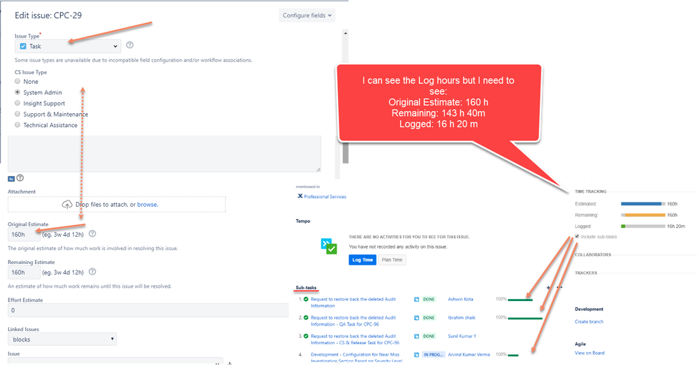

Hi there,
I'm experiencing something similar.  I have a Task with the Original estimate of 160 hours. We have a team that creates sub-tasks and have logged hours under each sub-task.  How can I summarize the logged hours of the sub-task AND deducted from the Original so that it shows in the Remaining?  See my screenshot
