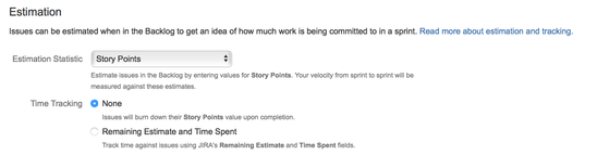

Moses,
My guess is because you're using Story Points.
Victor

This is under board settings right? Tried it. not sure why still not showing.
Victor Mutambuki
September 13, 2018
Correct. Board Settings --> Estimation.
Select None for Time Tracking.

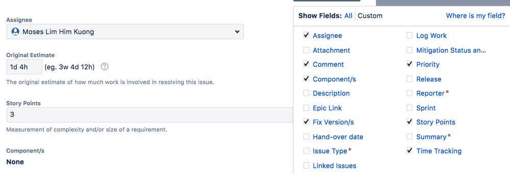

Moses Lim Him Kuong
September 13, 2018
Yes, below is an attachment of the edit mode.
