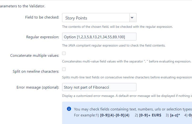

Hello,
Im trying to add a validator with alert message pop up if storypoint is not within the Fibonacci Sequence. However, the below code is appearing to alert for all numbers. Please assist with the below?
  • Regular expression: Option [1,2,3,5,8,13,21,34,55,89,144Story Point.JPG

@Mikael Sandberg Thank you for your response!
I have just try this script and it doesnt seem to be working. The alert appears to be stopping only 2 digits number. However, our end goal is to stop the user from entering in any numbers that not within the given option of  (1,2,3,5,8,13,21,34,55,89,144)
Any other ideas?
Sandy Xiong
September 21, 2022
@Mikael Sandberg Okay i think i got this to work. However do you know if Jira will allow us to put this into Prod at a specific date? Example, if i want to implement this script next week and anything before next week does not need to follow this rule.
