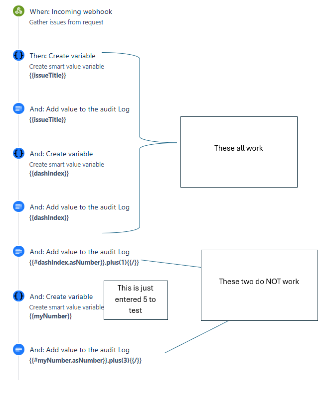

So what I was able to do is get the index of the start of the string I want to extract, stored that as a variable, then figured I can use the index value plus notation to get the next 5 characters that I want. But I am still having issues.
I am debugging by writing to the log, but while the automation does not fail or error, nothing is getting writing to the log. It seems the asNumber may not be working either.

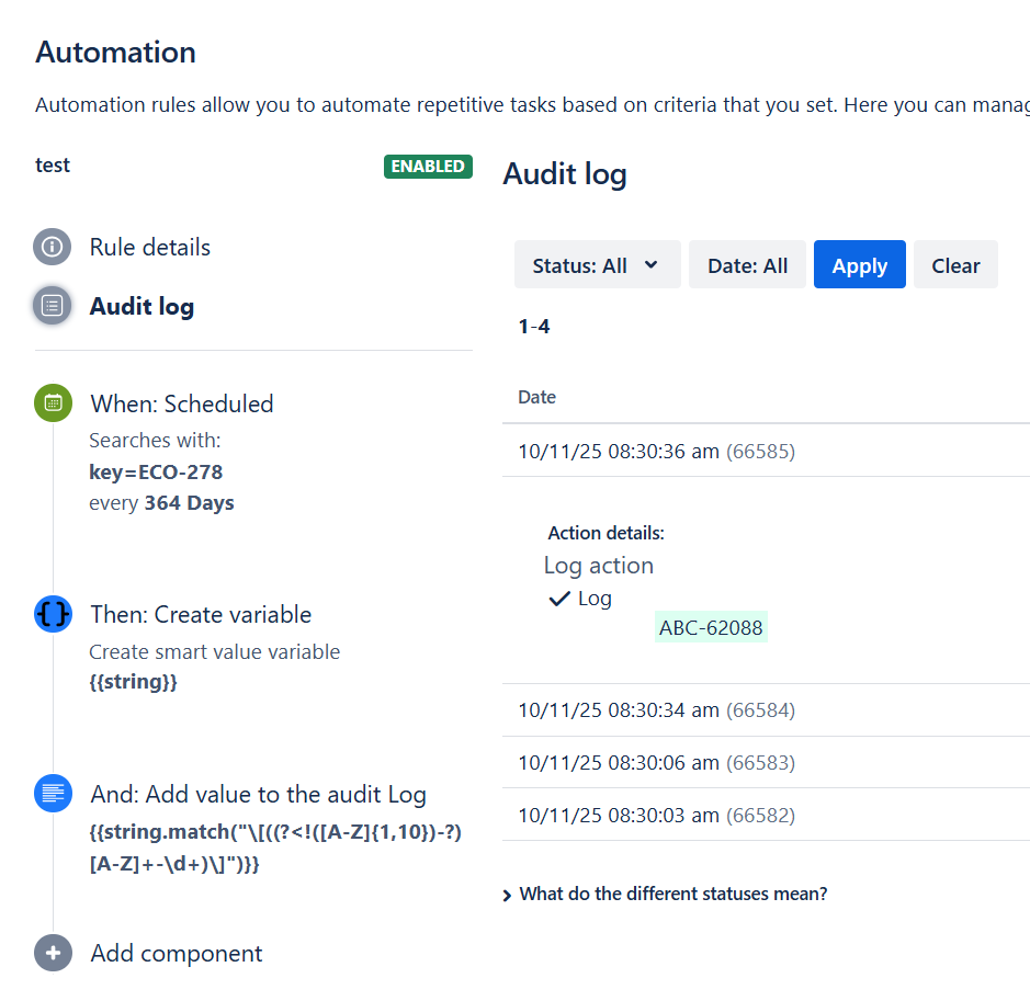

Ok, suppose you have the string you mentioned in a var called 'string'
string: [Feature][MATRIX][Code 2025.4.5][ABC-62088] Migration Service – CI/CD Setup for EU
Then you create a new var called myKey:

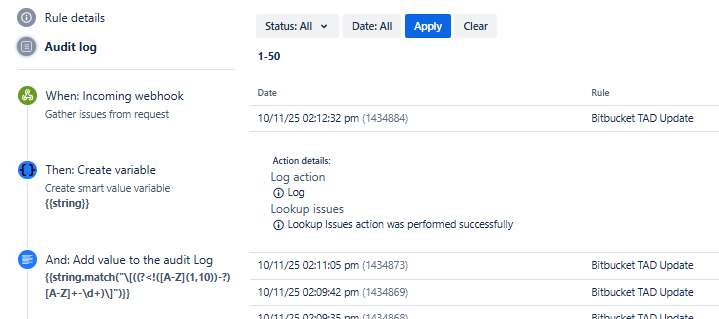

myKey: {{string.match("\[((?<!([A-Z]{1,10})-?)[A-Z]+-\d+)\]")}}
This will output ABC-62088, as you can see below. The regex will search for a Jira key within square brackets, so if another key is located in text at the end, you still get the correct key.

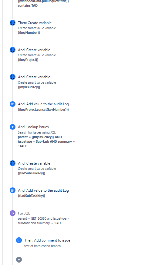

Thank you @Rudy Holtkamp I had tried before, but maybe I goofed something up. I was able to get the info I wanted through a rather inelegant workaround. So I have the key of the sub-task I want, but am having serious brain cramps now as I can not figure out how to get the action I want (transition, but just trying comment for debugging now) on that sub-task. Since the trigger is a webhook there is no "trigger issue". I tried to branch on JQL using the key I was able to extract (I also tried it with the key hard-coded to test) but the add comment action does nothing.
Strange, It did when I tried it on a Jira DC instance.

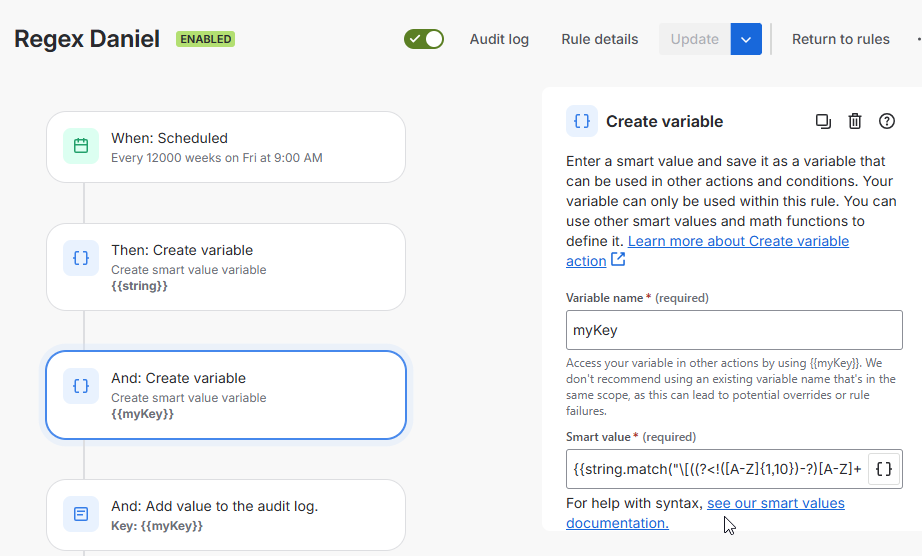

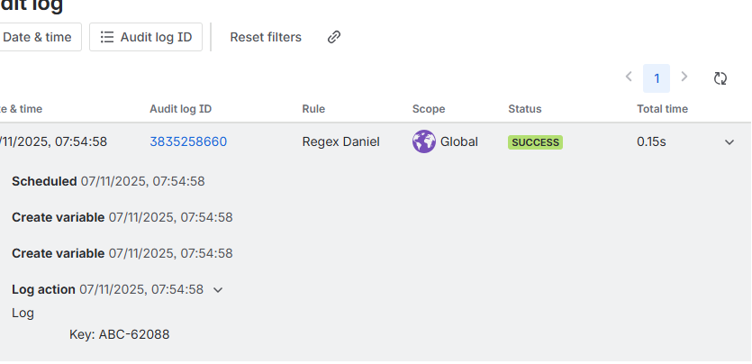

@Rudy Holtkamp I wanted to let you know that your post above where you recommended this
worked.
The reason it did not before was due to the way I had the webhook trigger set up.
So thank you!
