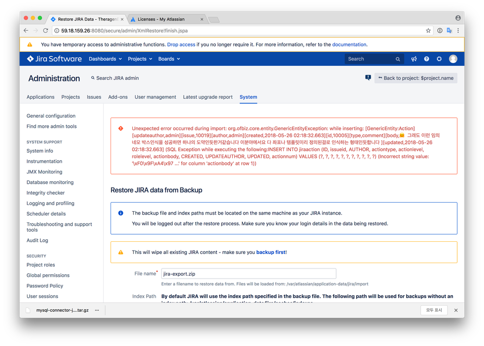

I'm moving Cloud to Self-Hosted Jira.
When I try to restore the Jira system using export file(jira-export.zip),
I got the error in below.
Please check this problem.

The database you have chosen for your server installation does not support some of the characters you have in your data.
My guess is that you are using MySQL, MS-SQL or H2 (the internal one which you should not use for anything other than small dev or test systems) which all can have this problem.
Your options are:
  • Remove the data that the database can't handle
  • Use a database that can handle it (PostGres)
  • Reconfigure the database so it can handle it.  Some people have reported that swapping the MySQL collation to utf8mb4 can fix it for example
See https://confluence.atlassian.com/jirakb/jira-does-not-work-with-emoji-4-byte-characters-429919955.html for a bit more.

I tried to restore with PostGres. It works well.But I do not have more experience for PostGres.
so I want to use the mysql for Jira.
 How can I remove the only data that can't handle in export zip file?

Cleaning the xmlcan be done by searching for the stuff that cannot be handled by your database and manually removing it.
However, try the xml-cleaner first - see https://confluence.atlassian.com/jira/removing-invalid-characters-from-xml-backups-12079.html
