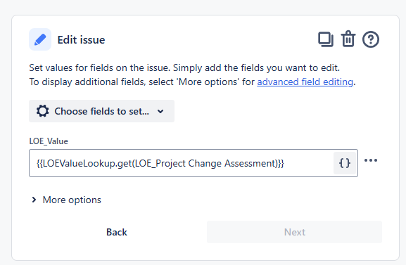

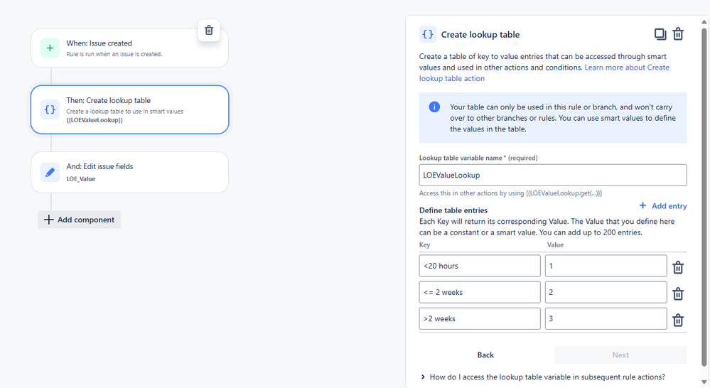

Here is the automation - it's pretty basic, Would the field value changed trigger need to be another automation? I have 6 fields total so I'd need an automation for each field & it's lookup table/assignment and another one for the value changed trigger?

The Field Value Changed trigger catches the change to the field during issue creation. You don't need a rule triggered by Issue Created and a separate rule triggered by Field Value Changed.
I would recommend using a separate rule for each field.
With the Field Value Changed trigger you can identify multiple fields to monitor for change. However you might then need to add logic to the rule to figure out which fields actually changed. That would add complexity to the rule.
If you use a separate rule for each field, the rule will trigger only if the one specified field changed.
