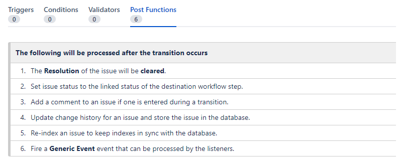

Can you check the workflow and specifically look for the post-functions - does it contain 'Update change history for an issue and store the issue in the database.'?
The default post-functions should be 5:
 - set issue in destination status
 - add comment if one was provided
 - update change history
 - re-index issue
 - fire a notification event
Another thing - was the issue being transitioned in a "natural" way or was it pushed through a script, plugin, automation? Using Java API issue history can be skipped.
Is this reproducible? I really don't think that it skipped saving issue history because it had a rainy day - there should be a better reason for it.

Hi! I have confirmed the post-functions of the transition and it looks good. It does have the Update change history post function added. Also, there were no issues with JSU plugins at that moment on 18th june because there are multiple projects which uses JSU and no one else reported any issues. With this ticket, the status change history was recorded in the "History" tab but not in the "Transition" tab.
