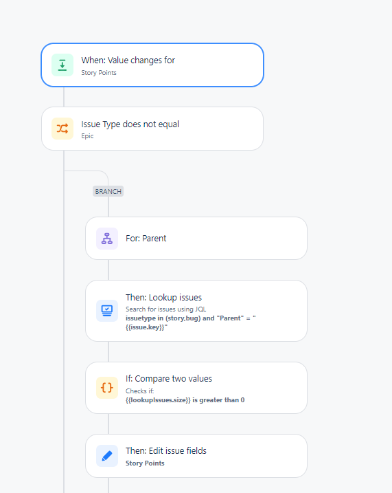

I am trying to do this as well. I have an existing rule to calculate Story Points on an epic which is working perfectly.
I tried creating a new rule as suggested in this post to re-calculate whenever a story is changed to Cancelled, but I'm not having any luck. Hoping someone has a suggestion.
Thank you!
christopher_branaman
August 6, 2024
Nevermind, I figured it out. I simply had things in the wrong order.
correct query is
issuetype in (story,bug) and Status not in (Cancelled) and "Parent" = "{{issue.key}}"
