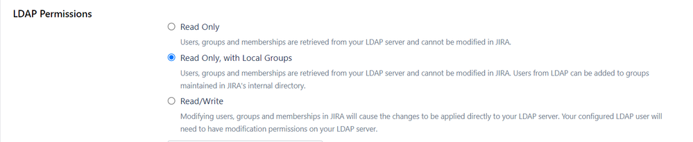

We have an instance of Jira Server that is configured to use our LDAP server (ORM LDAP Server) for authentication as shown below:

Hello @Don Carlos Abrams ,
If I understood correctly, you no longer want to be able to add LDAP users to local Jira groups, if this is the case you have to change the LDAP permission to "Read only" (currently it's set to "Read only, with local groups").
For further details please have a look at : Connecting to an LDAP directory
Kind regards.

No.  We don't want to be able to modify the LDAP-supplied groups via Jira.  We still need to be able to add LDAP users to the local Jira groups.
With the permission parameter set up to "Read only, with local groups", you are not updating the LDAP server when you add a local user to an LDAP group. Indeed Jira create a "copy" of all the LDAP groups. So in reality you're not managing or modifying the LDAP group, you're only managing this "copies" from the UI.

Thanks, but you can still modify the copy of the LDAP-supplied group and that's what we want to prevent.
