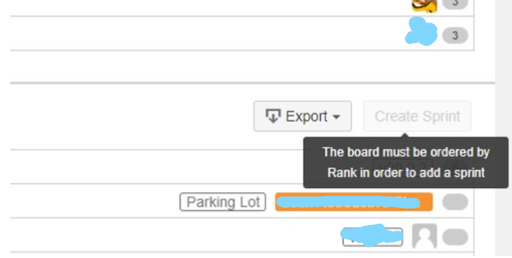

@Veera - hi Veera, thank you for your reply. That's correct. The Sprint button is grayed out. Our Jira Admin, tried to drag an issue into an existing Sprint and it wouldn't allow him to either..
Please see screenshot (we are also unable to right click and assign to a Sprint). As soon as we enable the default Jira rank, the Sprint functions as expected.

Veera
February 6, 2020
Hi @LG
Sorry for the late response.
Please check the board filter query and see if there is OR clause in it. If that's the case, the board may be trying to pull the tickets from multiple projects.
Users need to have _Manage Sprints_ permission across all the projects the filter is trying to pull the tickets from.
