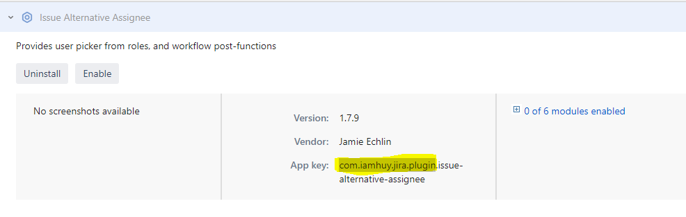

shattaraki
December 6, 2021
Hello Mohan,
First thing is need to check the which plugin package is causing the re-indexing failure.
In my case com.iamhuy.jira.plugin.customfields.UserPickerProjectRole it was associated with Issue Alternative Assignee plugin.
You can find the package name in App Key so that you can find easily which plugin is messing up with you.
Attached screenshot for your reference.

Mohan Sundar
December 7, 2021
Thank You for the response @Shivaprasad Hattaraki and for the help!
I was able to find that. Now disabled the plugin and was able to re-index successfully.
Thank Again!! Have a wonderful week ahead :)
