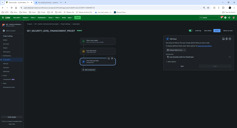

I'm trying something like this, copy security level from Parent.  But the issue is not "yet" created, so the trigger doesnt start.

How is the issue you want to modify getting created? Is that done manually, or are you trying to automate the creation of the issue?
If the issue has been created manually, then the manual creation of the issue will trigger this rule because it uses the Issue Created trigger.
If that is not happening in your environment, then there is some other problem.
If the rule is getting created but the Security Level is not getting set, that is again a different problem.
What is the output in the Audit Log for this rule when an issue of type "Financement projet" has been created?

@Trudy P Claspill The issue is created via the "hierarchy button" ... security level is not set and the automation (on creation), of course, cannot be triggered.  Maybe something is wrong in my config.

When you create the issue manually a dialog will open for you to fill in the fields to create that issue. Are you trying to automatically populate the Security Level field at this point? You cannot use an Automation Rule to update a field on the Create Issue screen.
The issue is not "created" until you save that information. Saving the information executes the Create transition within the workflow, which fires the Issue Created event, and that will trigger the Automation Rule.
To automatically fill in a field in the Create Issue dialog you would need a third party app such as Adaptavist's ScriptRunner Behaviours. However it is unclear to me if Behaviours supports managing the Security Level field.
https://docs.adaptavist.com/sr4jc/latest/features/behaviours/behaviours-supported-fields-and-products
