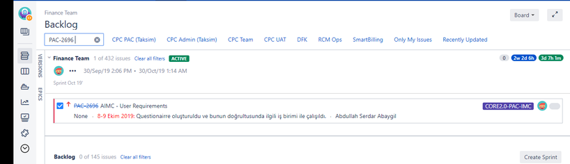

these are all strikethrough

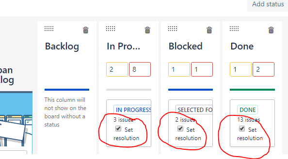

Can you share with us a screenshot of your workflow and board settings - columns
Vickey Palzor Lepcha
October 17, 2019

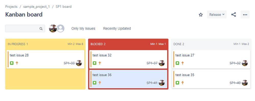

Looks at my screenshot below - I have marked " SET RESOLUTION " on all my COLUMNS - so all my issues have strikethrough as shown in the other screenshot1.PNG2.PNG

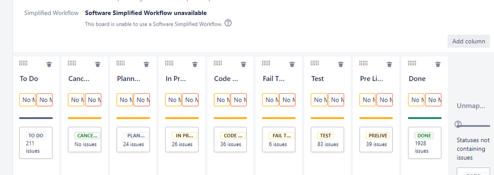

I mean this one re-opened and it is seen like in the screen shot below.

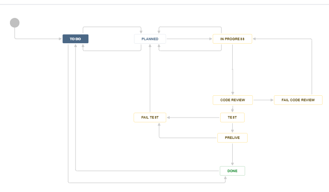

As pe the work flow , it does seem to be following what has been setup.

Hi,
Please review your wprkflow - check if Open Issue has a Transition from ALL.
