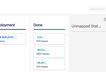

1&2) Yes the tickets that were added had the resolution set next to the status value.
3) The status is assigned to the issue mapped to the farthest.
4) Yes, only one project
5) There is no entry on history for when the sprint was added, just me removing it.
6) We don't have any automation rule to add it to the sprint.
Here is one of them, that was added randomly when I started the sprint. You can see also the parent, both were closed months ago with no other open tickets.
