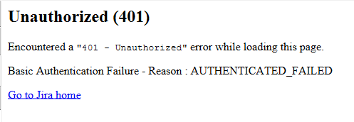

When we start execution, for example GET on https://jira.ourdomain.com/rest/api/2/applicationrole we see an error 401 Unauthorized (401). After some tries we get an error 403 and CAPTCHA is active for this user .
So it´s seems that data was correct and the username can be extracted from base64 encoded string by JIRA (base64 string is username:password).

thank you for your answer, first we see an error 401,2020-02-11_07h26_02.png
The used basic auth base64 string ist correct.
The 403 is shown after some tries when CAPTCHA is enabled.
User login data is correct, we use the same for Confluence basic logins (same Crowd directory). All users have full admin rights in JIRA, so it can´t be a permission problem.

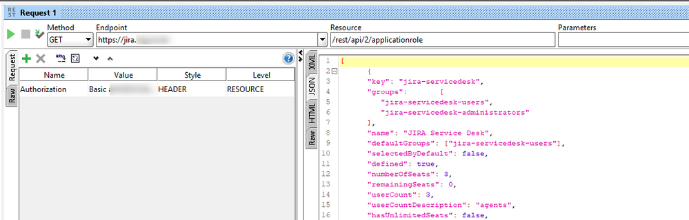

@Thomas Deiler I tried it once again (I imported the WADL too)
This call won´t work (error 401)
This call works, I used the same authorization credentials for both calls.
My user has full admin rights in JIRA and all projects.
Regards
