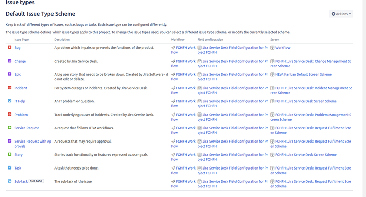

Paolo Di Bello
September 5, 2019
Here both the Issue types and request types.
Screenshot from 2019-09-05 17-56-54.pngScreenshot from 2019-09-05 17-57-16.png
Dario B
September 6, 2019
Hi @Paolo Di Bello ,
In short:
  • Issues are how pieces of work are internally represented Jira.
  • Requests are how issues are phrased or represented on the customer portal to customers or end users.
  • More request types can be based on the same issue type. Indeed, as you can see in the second screenshot you attached, each request type is related to an issue type and you have 3 request types associated to the IT Help issue type and 2 associated to the Service Request issue type.
For further details on this topic, please review the below documentation:
Please let me know if this explain.
Cheers,
Dario

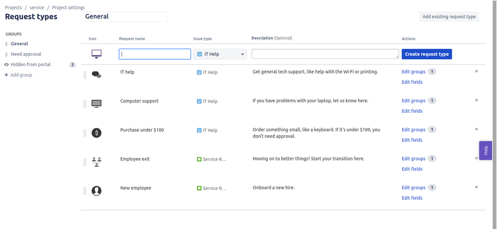

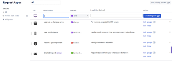

The request type for the only request I have
Screenshot from 2019-09-06 13-02-55.pngScreenshot from 2019-09-06 13-03-22.png
I only kept one request type for each issue type and deleted all the groups.

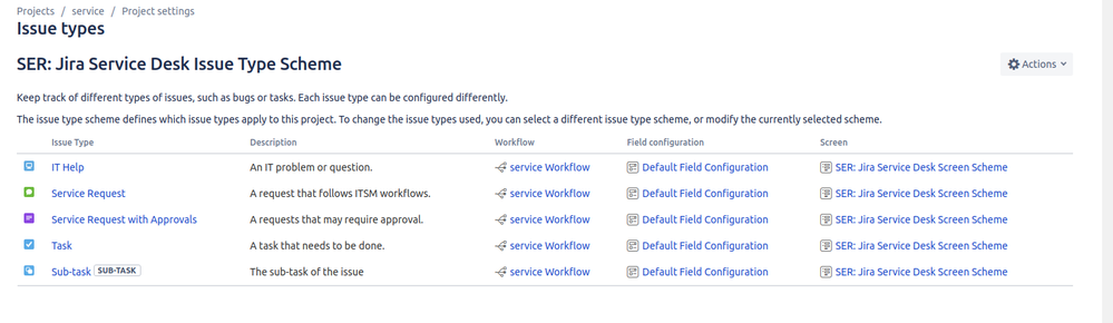

These are my issue types instead:

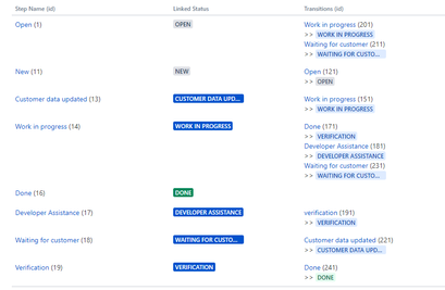

Jyothendra
October 18, 2023
Hi @Dario B ,
this is transition work flow as we fallow in my JSM.

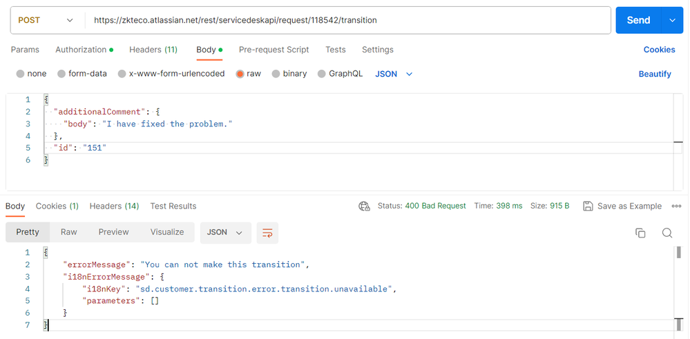

"I'm using the Service Desk APIs to change the status of an issue or ticket via the Transition REST API. The API token I'm using belongs to an administrator, and they are able to change the status in the web interface. However, when I use the following URL: https://org.atlassian.net/rest/servicedeskapi/request/{issueIdOrKey}/transition, I encounter the following issue."
please help me on this

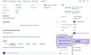

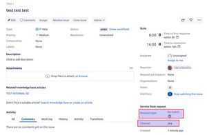

How do I know if a request type is set?
If you create the issue in Jira rather than from the customer portal, you may end up having a valid Jira issue but an invalid Service Desk request, since the request type is missing.
Missing request type:
Setting request type when missing:

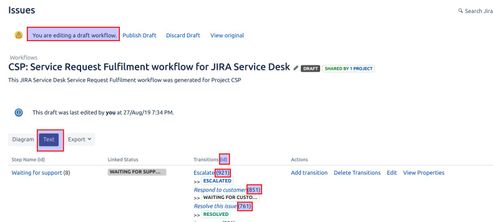

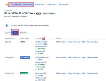

How do I get the transition ids?

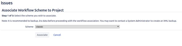

Easiest way is to edit the workflow associated to the project. I did exactly the same you did, I created a JSD project using the internal template and I configured it to use the classic workflow scheme.
Then, go to project setting and edit the workflow (text mode), you will see the transition ids:
About the REST API part, I have followed your steps (create internal SD project and change workflow scheme to classic) and I am able reproduce the reported behavior. I need to further look into this since it may be a bug or a change of behavior (or we are missing something).
